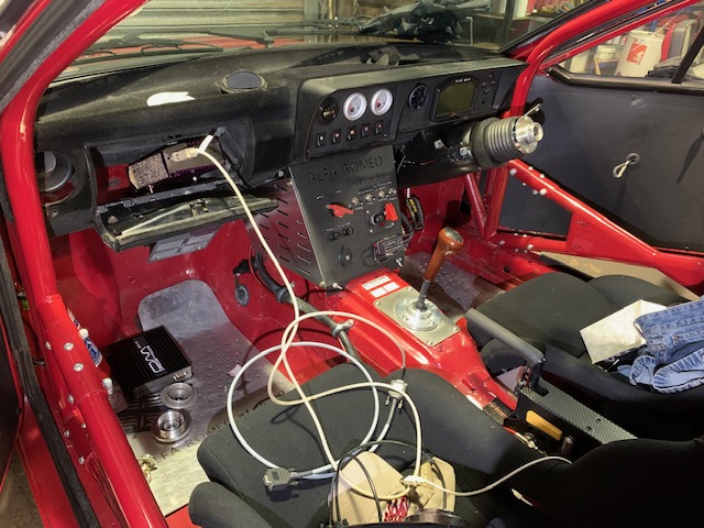

I have been trying to tidy up the exposed wiring in the cabin side side especially around consul and fuse box so I have laser cut some cover plates . The fuse box cover plate is mainly to hold it in position so you can unclip easy with out breaking back with roll cage in position . They must still be painted wrinkle black .
