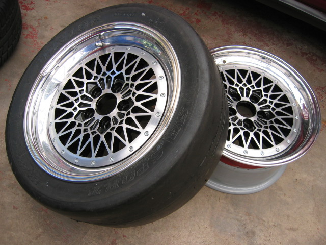

Baz, Fernando, do you recognise these wheels. The one without the tyre had the bent dish. Pressed the dent out and did minimal skimming to keep the wall thicknesses in safe condition.

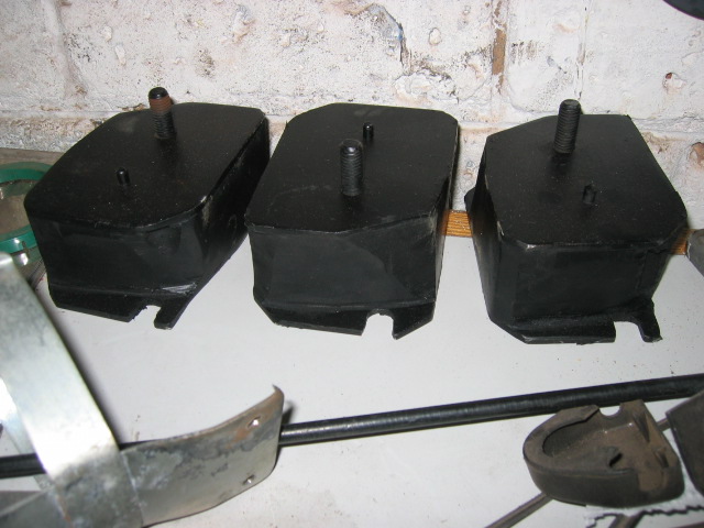

Jes, while ago you posted pics of engine mount with a 47 mm thickness on a new mount. Got mine back(47mm) which cost me R250 each. I went up to a shor hardness between 65-70. Went a bit heavier for track use. measured some standard ones at 55(shor hardness). I have founf a huge variation in the thicknesses of old mounts from 41mm up to 47mm.Pic follows

Kevin,very nice job on those Compo's. :D
Kev, another one of those racing compromises when you have to have a car for road and track. If it was for track only, you could have gone with solid mounts and live with the vibrations to be sure they never ripp off.
Without some other means of limiting the stress on the lamination, they can still delaminate under sufficient tension (especially the left side). That's why I went for a bush type conversion on the Brick. This is a compromise betweem vibration dampening and failing protection.
See :viewtopic.php?f=21&t=2828&st=0&sk=t&sd=a&start=90
The other thing is I suppose you could also fit an engine restraining bar to limit its movement.

Jason,
The "wobbling around" is irrelevant. If your engine has enough power and you use that power abrupt and repeatedly as one does in racing, it causes stresses on the engine mounts due to engine rotation in opposite direction of its internal rotation as it is transferring the torque down the driveshaft. The more the power and the better the traction, the greater the stress which ultimately will cause your engine mount failure. It will literally break up or delaminate apart. Engine builders understand this and often build interlocking top and bottom sections of mounts so as to limit the amount of travel whilst at the same time offering some level of damping provided by soft mounts.

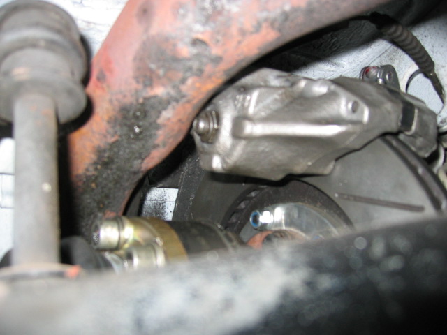

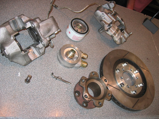

I got my rear ventilated discs in with widened calipers. Size of rear disc is identical to that of SZ. Again left everything to day before race(last Friday). Absolutely no leaks(should not be any) but forgot to make longer pins to hold pads. Panic set in as I was missing free practice .Lucky I had 6mm reinforcing bar on one of the construction sites which was quickly drilled and bent. Then I had the exhaust to close so had to make new brackets to pull it away from widened caliper. My next plan will be to bring exhaust out the side with oval 76mm to get neccassry clearance with cross over box. Bottom line brakes were exceptional this weekend. Some pics to follow
Engine temps seem to be a bit high so I put a theremostaticall controlled oil cooler in from m3 Beamer. Thought i would start here before I started with radiator(change from copper to Almn). Still ran hot in the race - 95 c on lap six when Domingoes TT ran cooler withtwo glowing turbos.

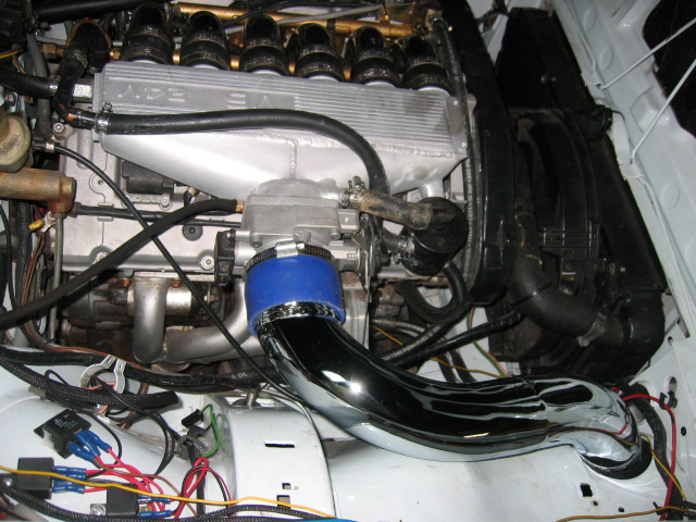

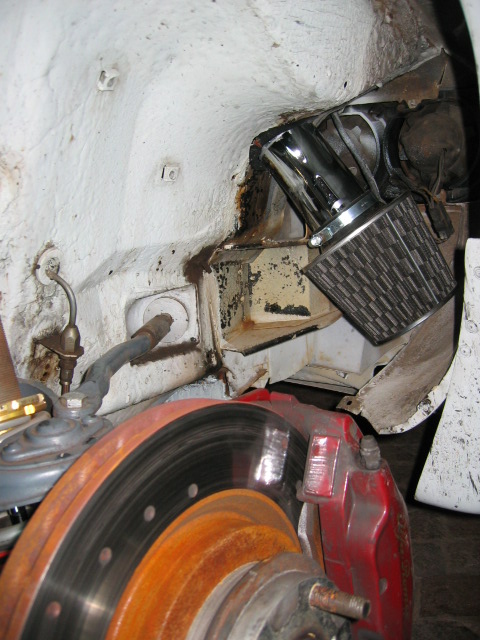

Intake pipe has been sorted from old consertina hose. The airfilter sits between splash guard and headlights. Must still make ducting to bring ait in there. Better than hot air off the manifolds.
