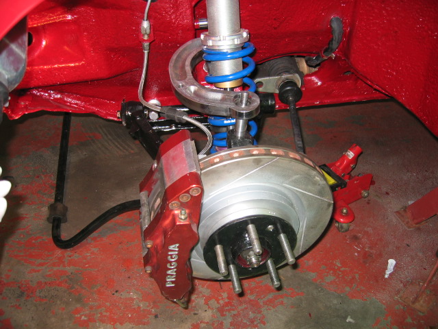

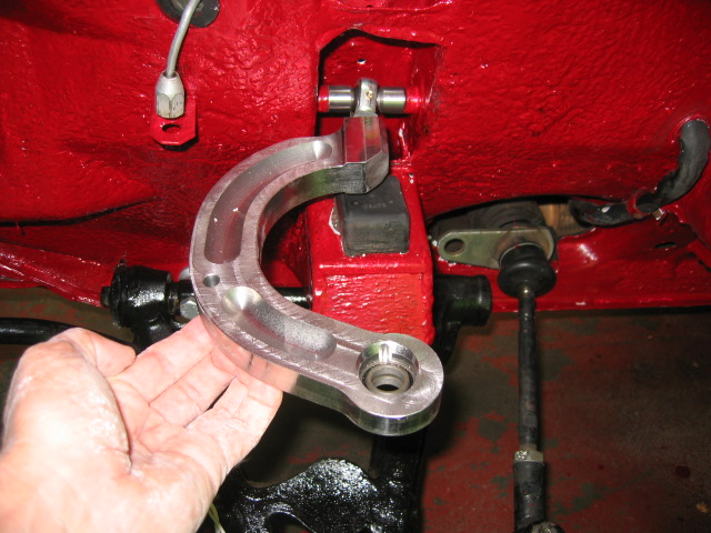

Just finished the upper control arms. Gives great clearance on the coil over. Nightmare to machine at the correct angle for the press fit sealed bearing.
Still making a whole lot of pins to get the optimal distance between the upper control arm and hub. Just a temporary pin made from a machined ball joint to hold it together until final one is made.

kevin wrote:Just finished the upper control arms. Gives great clearance on the coil over. Nightmare to machine at the correct angle for the press fit sealed bearing.
Mmmm. that looks very familiar Kevin :wink:

Thanks Andrew for supplying the originals. Had two machines running for a day just to cut four pairs. Not the lightest items around but thats not a problem for me as the torsion bars are history and will make up the lower arms shortly, so i will still be ahead in weight (saving).
I dont think any sets for resale use at this stage will be made as its a lot more costly than I thought. If there is enough interest and can get price down then we can make a plan. Barry and I are working on this aspect at the moment. If any one is interested contact Barry.
Just finished making pins. These pins are non adjustable unless I remove the taper in the stub then I can have a straight shaft and add spaces to the pins. I will try that if this set is not perfect for my set up.
This is probably the first case where some one has cut(destroyed) beautiful 305mm to 290mm so they can be used in a fifteen inch rim with the eight pot calipers. This 305mm will normally work in the 15nch rim if I was using smaller calipers. Sorry for cutting your discs Barry. (yeah i know I am going backwards but I have to use 15nch for race regs). Anti roll bar is in the making. Wish our currency was stronger so I can just order from RS.
Anyway here the pics
Testing rim size
Kev,stick the inner on as well..it normally fouls where the tyre goes into the fitment groove on the inner of the rim..
Verrrr nice ,huh??
Yeah, it clears no problem. its just the the 6mm bolts that brush close to the bleed screw. I am using a 7mm spacer to stop the inner from touching.
