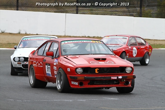

That's an awesome pic, looks like it's from the rolling start line up, Giuseppe is probably on my inside.

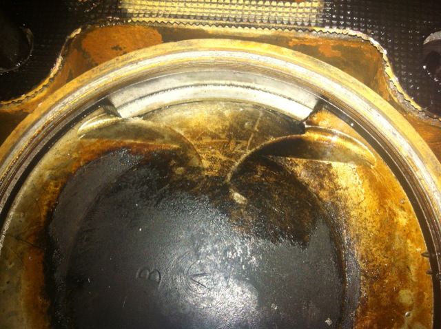

Long story short, there was terminal damage to the engine. Broken ring landings and one of the exhaust valve cotter came undone, Fortuneately the valve stem was jammed between the cotter and valve spring retaining cap.
I had a 2.5 sub assembly and a set of 2.5 reconditioned heads laying around gathering dust. The guys at POWERMODS were absolutely phenomenal, they had the engine out on Friday. On Saturday, with help from Boetie and guidance from the BOSS, we put the 2.5 engine together. On Monday POWERMODS installed the engine in the car and had it running.
Finally we put it on the Dyno. To our surprise, after a couple of runs all the smoke, huffing and puffing cleared up and the motor seems to have settled and bedded in. Once again the BOSS has worked his magic and brought life back into an old motor.
As things stand we'll be racing at Midvaal this week end. Only time will tell...............

- Broken ring landing
