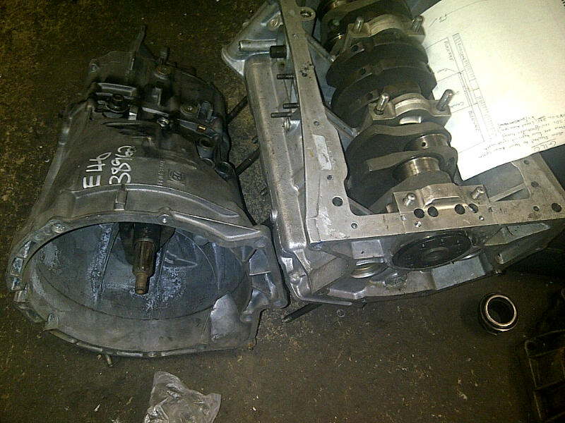

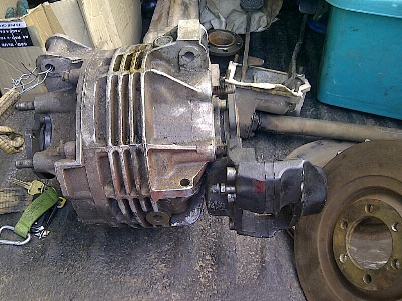

Pics of my gearbox with dummy engine so I can make clutch unit. I have no calipers for the rear that fit so I trying to save "some " bucks and use the original front brembos on the rear with a custom disc set up. Problem is the brembos are very thick and have to be 40mm at least away the box .
Some other interesting measurment I have found is the 119 diff from hub to hub is 285mm while the 116 box is 325mm. Also note is the 119 side shafts are 20mm longer than the 116 side shafts . Atleast the bolt pattern on the side shaftes on both series is the same BUT the bolt pattern on the hub (half shafts that go into the diff are different) . hope some of this makes sense . Trying to document this as much as possible to help next person who wants to do this and does not have a complte 119 donor car availble because that is the easiest way.

Kevin,
Brakes
Seems like you have 2 choices.
1 Fit spacers on the caliper mounts and spacers on the axle mount. (dont like this one)
2 Fit a conversion plate onto the existing mounts and fit the caliper in its original alignment. This will need a bigger rotor. If you have too much rear braking, cut down some of the pad friction material until you get a balance.
Brakes
Good info on the shaft lengths...
I have the Sei diff with the spacers/adapters that hold the discs. But no Sei shafts in my posession ( and impossible to find..), just 75/GTV6 ones.
So i'll probably need to make a spacer of some kind to make it fit.
My discs and calipers are in the wheels, so that problem has been tackled.

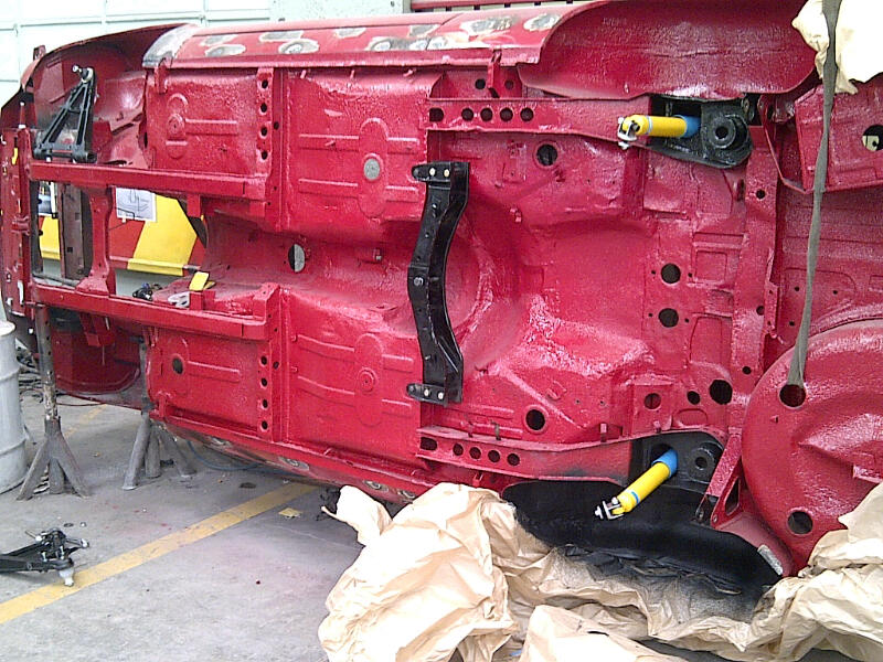

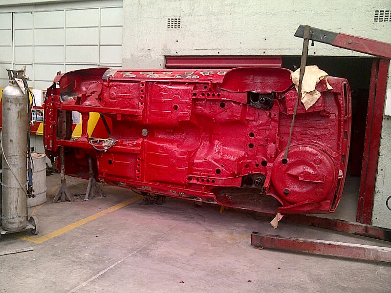

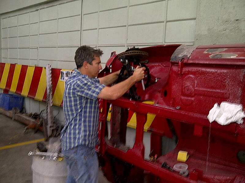

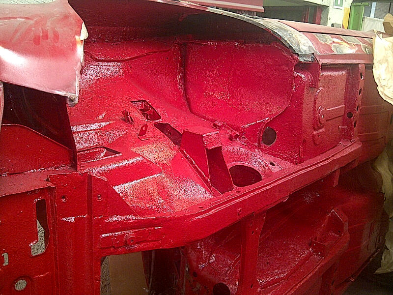

Some pics showing some progress . Been hectic as im trying to finish a 3.0 12v race motor which will go into my old white race car and the 3.7 is gonna be transplanted into this car below. Fernando used a really tough underbody coat to cover his artwork
Im just gonna get car on its wheels at this stage then fit all the duplicate parts I made when building the white race car .

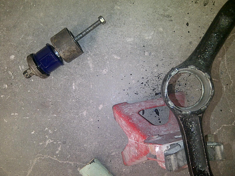

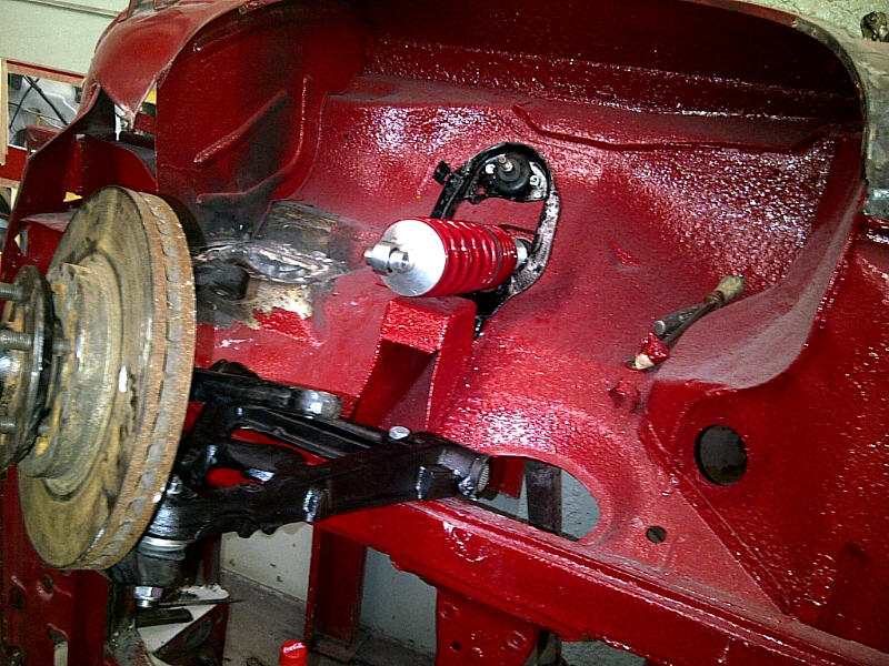

Some more pics to update. I have used a polyurethane bush for dedion . I have used it in the past and never had any issues . I ran out of time getting another spherical bearing from Ron .
All ball joints , rod ends and bushes in suspension have been replaced . Steering rack has been refurbished as well . I did not take pics yet of that .
Got the new Bilsteins on rear . Will follow with a set of RS 50kg springs ( gone softer on rear by 15kg compared to the white race car)
- susrear.jpg (134.33 KiB) Viewed 8798 times
- susdedbush.jpg (111.04 KiB) Viewed 8798 times

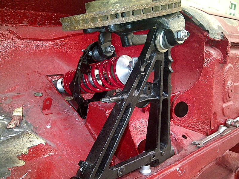

Started fitting the front suspension . Again with bilsteins . The discs on are just tempory to get car on wheels . Big thanks to Fernando for making sure I dont put back parts that are not painted and also for ensuring good welding standards with zero shortcuts are taken to make this a proper car. Some times you get lazy and just want to assemble to quickly and just use the 4pd hammer when you need more space ie when make space for castor arm ball joint from 105 series.

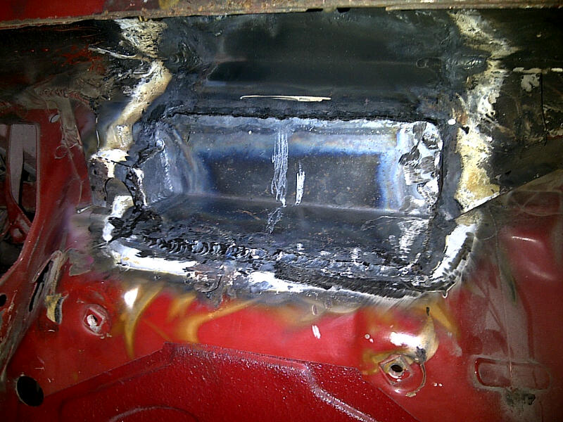

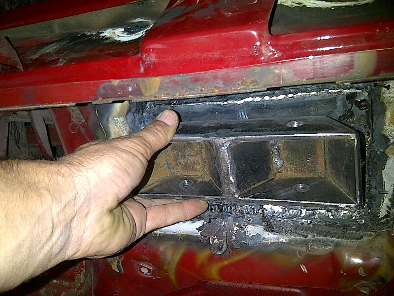

Working on doing some triangular bracing to firewall from the shock towers. I have welded the roll cage the firewall previously where it passes through to the engine bay . The firewall has been cut to receive an insert plate . This plate joins up the box section in the firewall.
Difficult part is to keep enough clearance for the widscreen wiper mechanism,

Kevin,
Just be aware that there may be some fouling of the brake reservoirs by one of the braces which could require the fitment of remotes. Installing removable bracing is also the best idea for maintenance purposes as you are doing.
Md , yes i looked at this , it's gonna be close but their is direct space from top of shock mount to centre point of windscreen wiper . But having said this it's not gonna be straight forward . I might have to make a creative design on the removable cross brace .

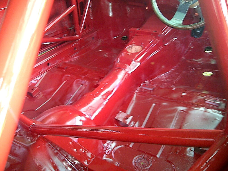

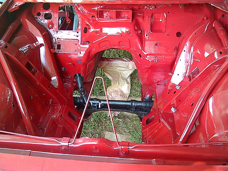

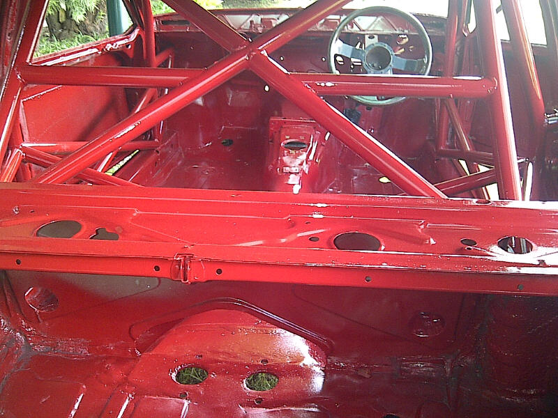

Some pics of inside been painted. Still got to repaint the outside but first assembly then touch up . Its not perfect as we have run out of time and the external is the main priority .
- gardredside.jpg (108.41 KiB) Viewed 8703 times
- gardredinside.jpg (120.32 KiB) Viewed 8703 times
