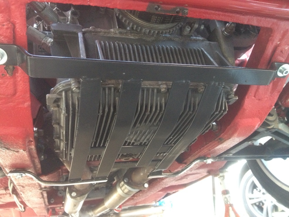

Just fitted the original sump guard that comes standard on the South African cars . Also helps toward the chassis rail bracing . The fixings go internaly and not just welded to the thin guage steel . I often rode on this on the kerb in the final corner at Zwartkops . Damm more wait added .
- image.jpg (220.89 KiB) Viewed 9141 times

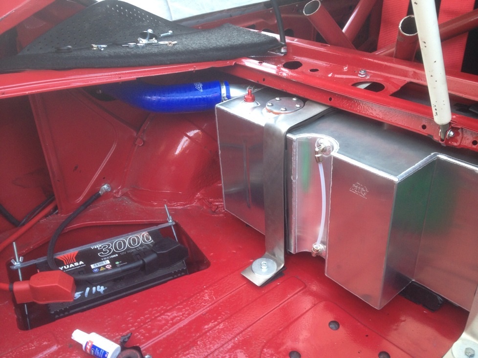

With spring approaching I thought it was appropriate to do some testing on the back roads . I used my 17" tyres as I have discovered that my 15" brand new semi slicks are not road legal here in UK but somehow are approved in SA . Car goes extremely well but a real struggle to get traction with the old 17" tyres , short ratios , 50 kg rear springs on bumpy roads but what absolutely huge fun .

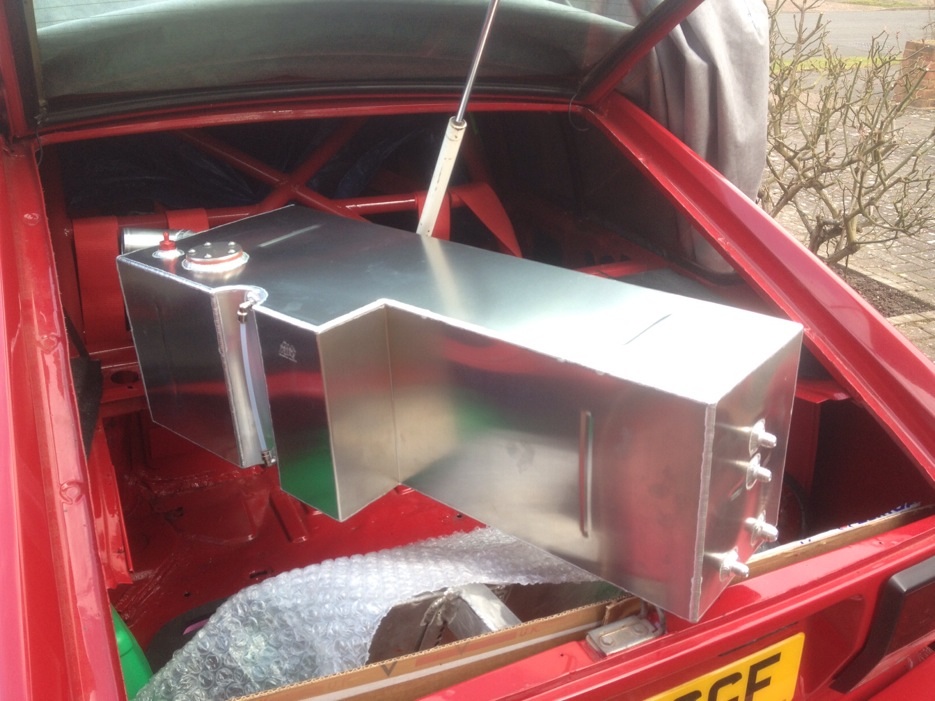

My fuel tank however keeps leaking on some welds even after rewelding it so thought it would be prudent to a professional to make a new rank with a totally different design as this is no longer a pure race car but more trackday , occasional race and possibly some hill climbs .
So new tank would need to hold more fuel ie 50 litres , baffled , foam filled , internal swirl pot , roll over valve , VDO sender unit facility , recessed site guage and stepped so two spare wheels can fit in the boot . Running an internal swirl pot requires a Facet red top pump to keep it fed as well .
AH fabrications were brilliant as I scribbled the design and sent it by email . The guys ( Lars Jones) made it exactly to the dimensions with superb welding .
I did not want any lugs this time on the tank as I have realised that's a huge mistake as it places stresses on pin point areas unlike spreading the loadings with a tray and straps .

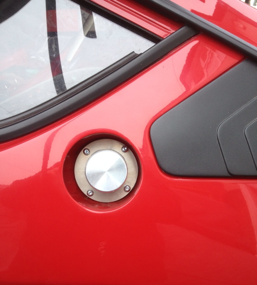

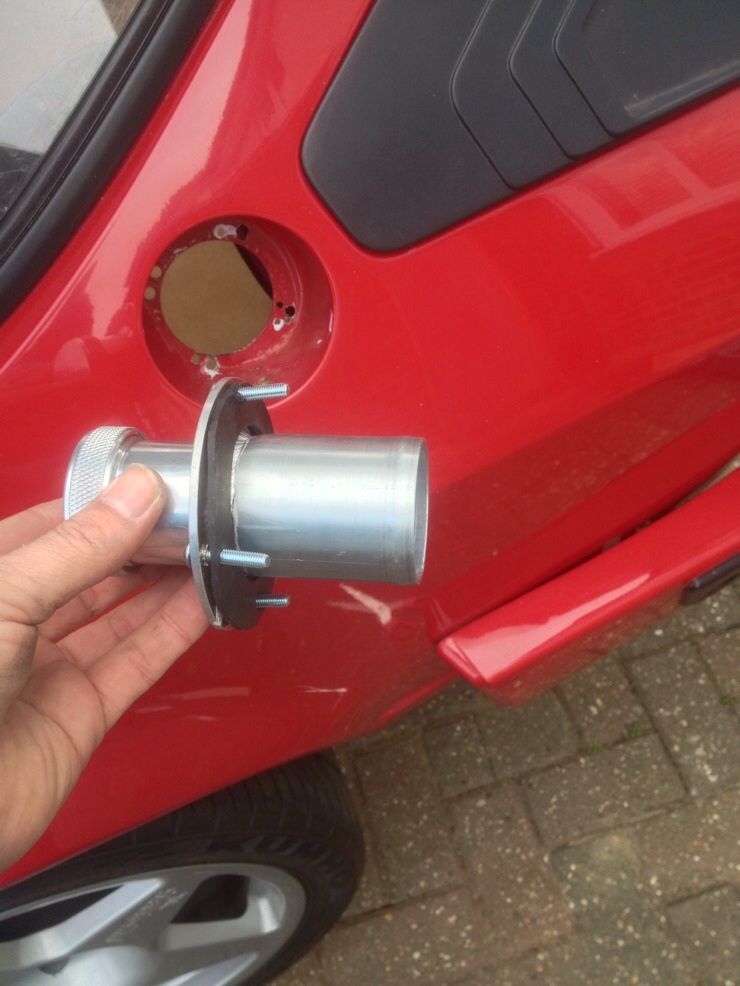

This time I also wanted to fill the tank externally so the inlet on tank had to be fractionally lower than filler neck . I did not want to drill into the body to install a flush filler neck so got AH to modify their custom fillers ( 100% leak proof with O ring) which has a knurled cap . It sits just below level of body work and enough space to tighten firmly . Just waiting now for a 45 degree elbow 51mm flouro lined fuel pipe to join up and all the JiC fittings to hook it all up . Also need to close off old holes into boot where existing pipework came through with a proper plate and sealed o rings around the pipework .
Hopefully after Easter and some more finances work will continue
Some pics of progress now that suns out .

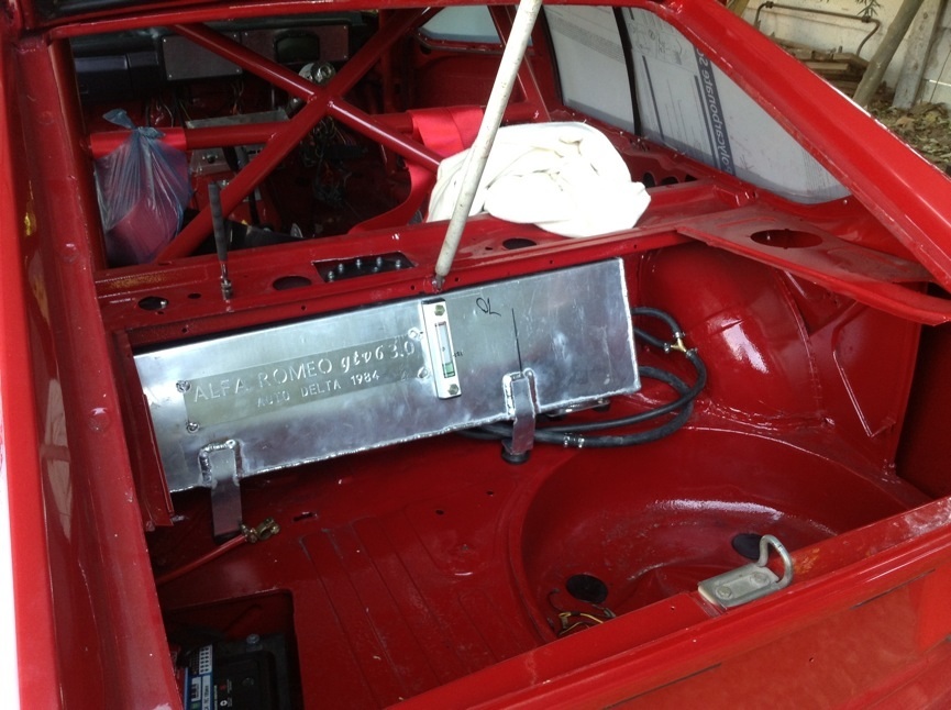

Pic of old tank
- image.jpg (166.42 KiB) Viewed 9082 times

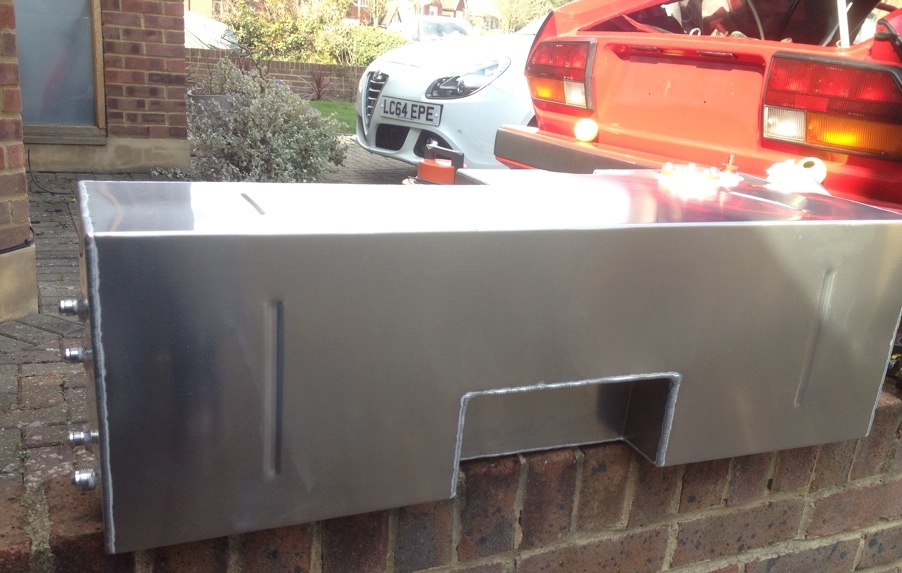

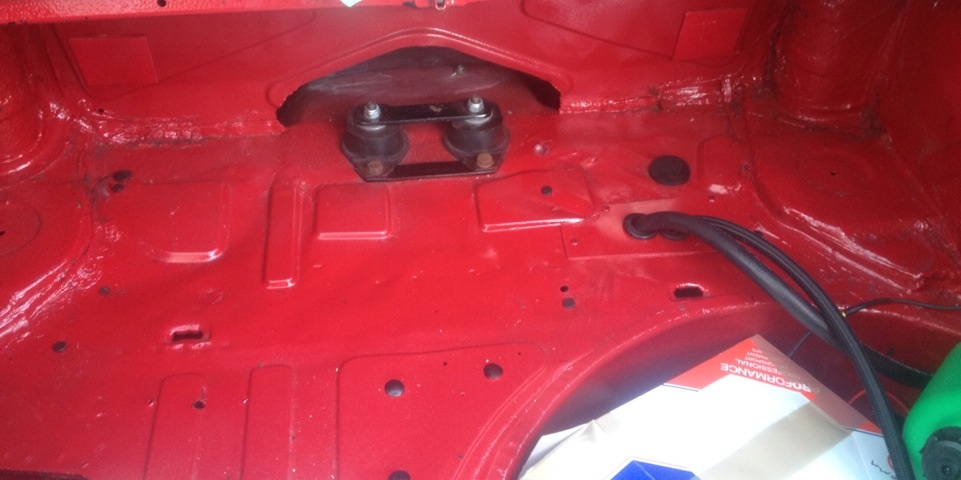

New tank . Note recess in rear of tank where diff is mounted to reinforced mounting plate in boot .

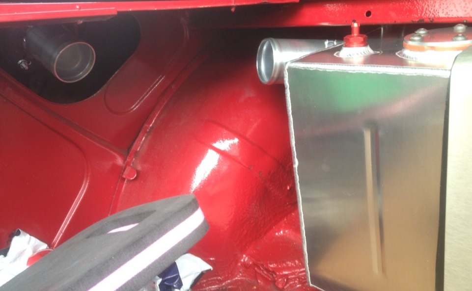

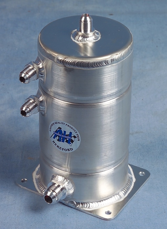

The internal swirl pot which sits against right side of tank and its fittings .

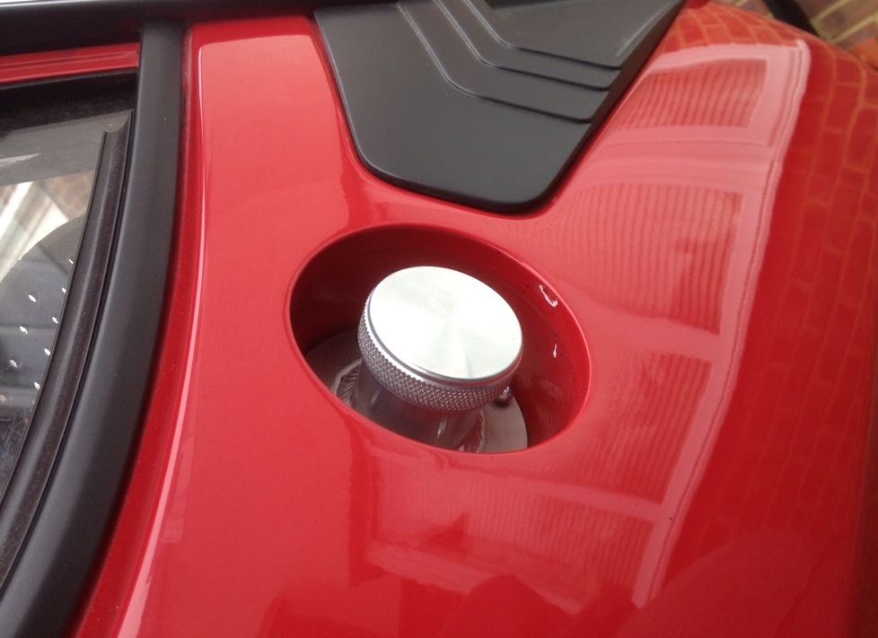

Pic does not show cap is central but it is
The straps have rubber linings underneath them but still lots of work ahead to get it perfect .

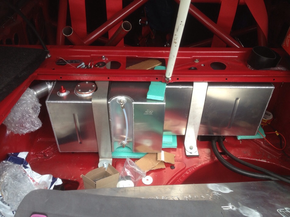

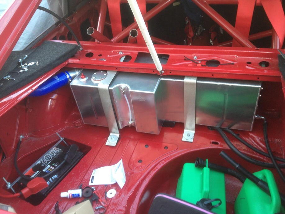

And tank in position with packers provisionally . Propper fluoro lined silicone filler hose for petrol .
Between the shock towers are rubber wedges to prevent tank moving sideways . Thin Rubber padding also wraps behind the tank against body .

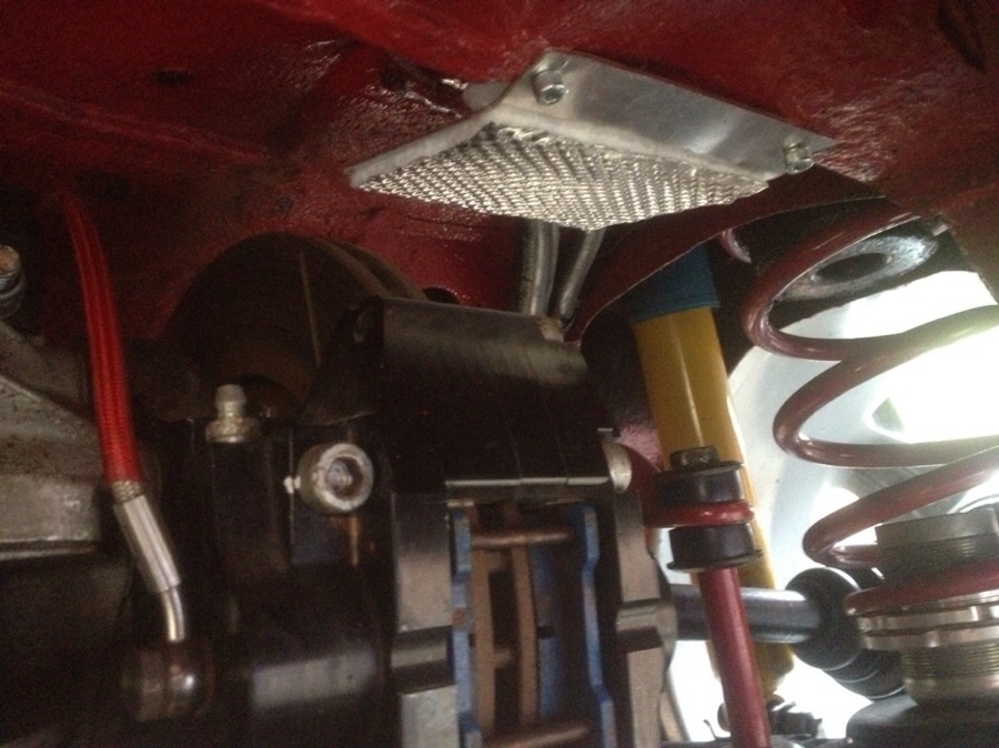

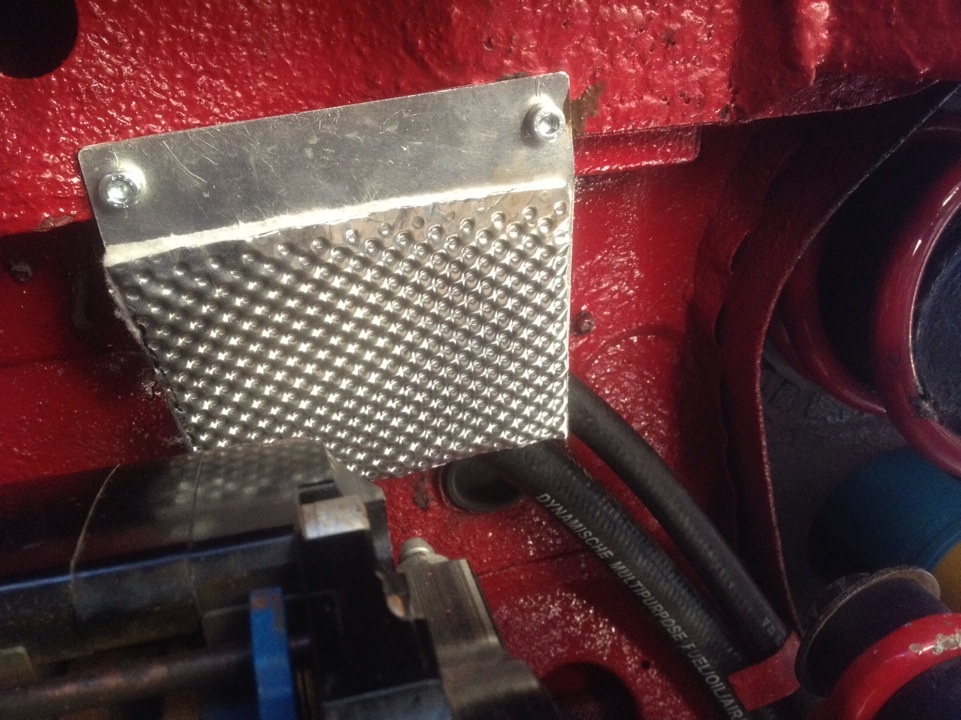

As the inboard discs are quite large and close to fuel line I have added a heat sheild . Also if their happens to be a leak on the connections the fuel drip will be deflected away from a hot disc brake .

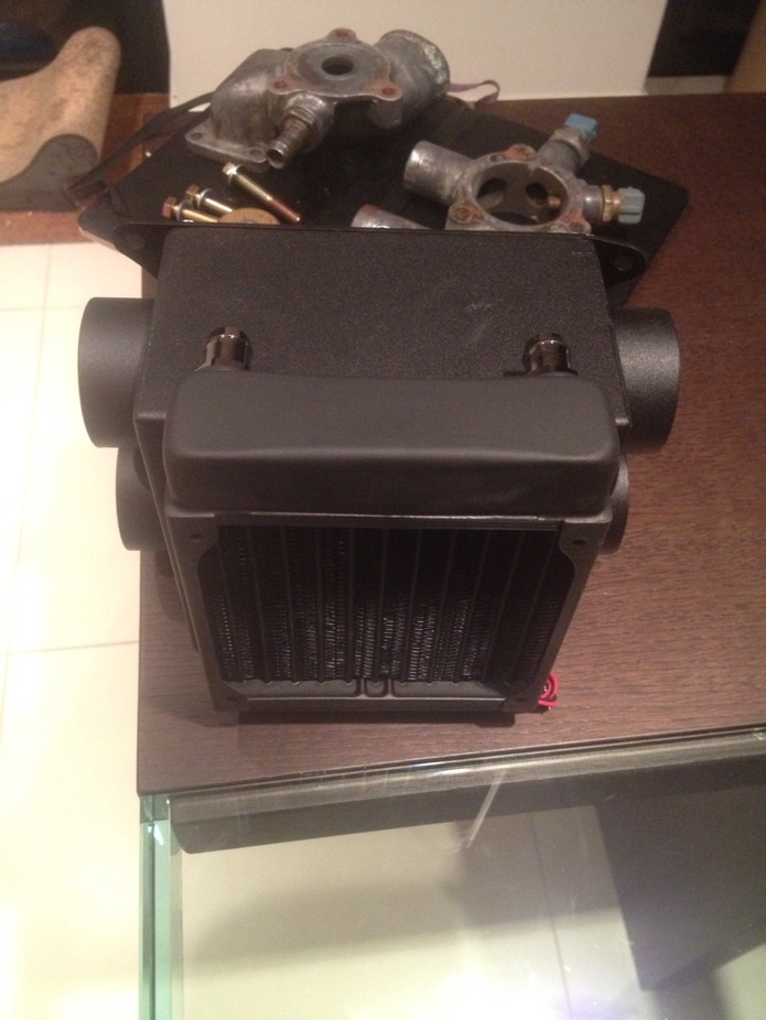

The question is about the best way to demist a race car ( mine) with my aftermarket heater unit . My car does not have AC to help dehumidify the air while you blast the screen with the heater to raise the dew point and stop condensation .
Generally the car will be indoors over night so I won't need to cater for previous day trapped air with higher humidity coming into contact with the cold windscreen - like on my car that stands outside .
Getting back to question for my aftermarket heater that's piped in using existing water pipes and venting onto front window , should I recirculate the air that's in the cabin or draw in air from outside ?? In this instance I'm trying to demist on a rainy day ( very often in UK
) but in the summer months ( not that warm in the UK) .

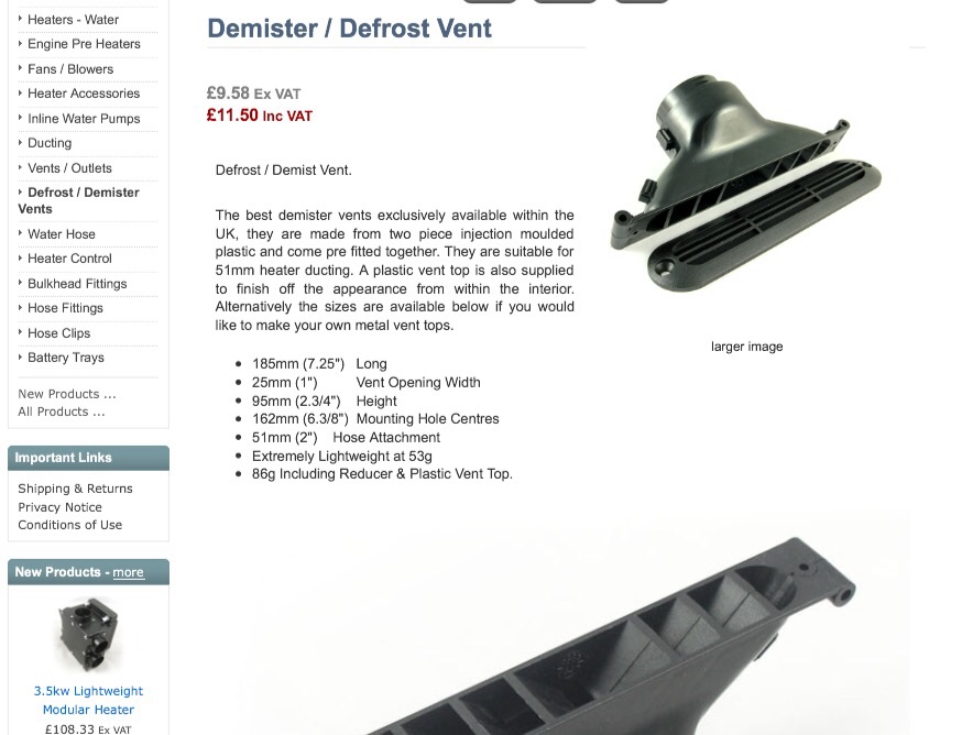

http://www.t7design.co.uk/index.php?mai ... cts_id=180

My thoughts at this stage is to possible have ducting to heater from inside and outside and then you switch over depending on outside air temp or the speed you driving at .
Also by not having and carpeting and insulation in the car the cabin temp would much hotter than normal so they are many variables !
