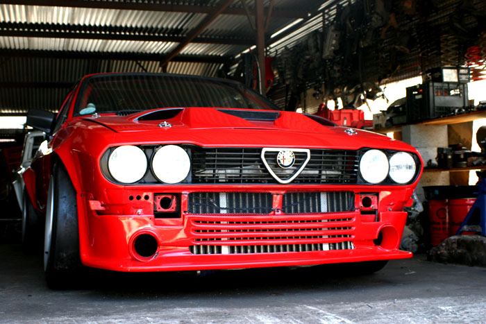

Race number two coming up next weekend. My car should be running shortly. Problem was broken valve spring. Anyway Dawie de Villiers junior will be driving the monstrous tt bigbore 24v with front mount gearbox. The bodywork has been restored perfectly with the legendry double vented bonnet off the origional TT that campaigned in the early ninetees. Few pics to follow. pics of engine will come at race day.

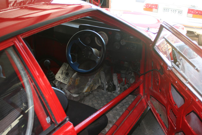

Put the car on a weight loss program by stripping out all sound deadening. Next will by using fiberglass doors,bumpers and bootlid. This will probably bring tha car back to standard weight with all the extra kgs i have added by using 305mm discs, 30mm antiroll, coilovers,24v motor, roll cage and fire extinguisher.
Trying to fing a few chaps here to share the costs of moulds.

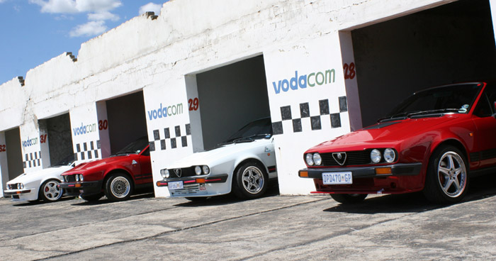

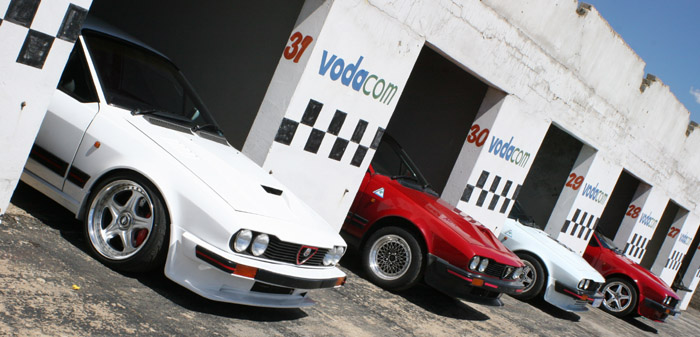

I took two cars(my dad drove one of them) to the track to compare. The 3.2 24v(205kw) with 17'' road tyres, big brakes, full RS and the 3.0 24v(190kw) race with all the above but 15'' semi slicks and 30mm lower.
Result, the semi slicks are nine seconds quicker over 2.4km track. It was like driving on ice trying to push it the same. I also believe the 17'' bridgestone road tyre have also got a bit hard over time as the lay at Barrys house for a while until he donated them to me.
Konrad brought his WRX and his standard GTV 3.0l carb as well. We found that the WRX and the carby GTvV were even down the 800m straight. Pretty surprising we thought. Sadly could not compare lap times as WRX was on road tyres and he did not want to wear them out totally but he was a few seconds quicker in his GTV. Great day was had and even my pops did a few quick laps, not bad for 72yrs. Few pics to follow.
