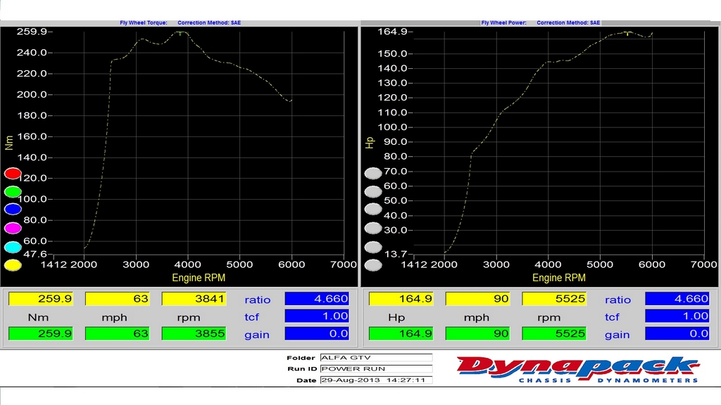

Initial tuning produced peak torque around 3800 rpm and fell away fairly quickly. This result would be great for a street car that didn't need to be revved to the limit all the time and it would do a great job in standing starts from the lights..
The second tuning flattened out the torque to be more useful on the track and at the end of the season after using it for about a year or so, it produced the quickest time for our car at Lakeside Park raceway. The time was sub 63seconds which is meaningless to anyone who is not familiar with the track. Suffice to say, it would place it in the front runner stakes amongst other Alfas. So that is pleasing result.
- Alfetta GTV Supercharged dyno results resized.jpg (219 KiB) Viewed 13574 times
- Torque & Power Orange Cab Dyno May.2014_cr resized.jpg (96.46 KiB) Viewed 13574 times

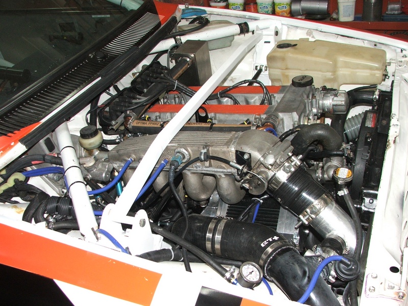

So for 2015, we have a fresh engine, new supercharger, new intercooler, new Hankook tyres, new dashboard instrumentation, some suspension revisions, a hydraulic handbrake, bit of aero and a tuning headache. It may need water injection to cool the detonation issues and we will work through that as time goes on. Lots of other detail changes too many to list.
So new challenges but a sheitload of fun. Can't wait to se how it runs when we finally get the tuning right. Notwithstanding this little setback the car goes hard and its a great buzz to drive it. The Hankook Ventus Z214 tyres stick like sheit to a blanket.

- Rear.JPG (222.77 KiB) Viewed 13573 times
- New Dashboard.JPG (232.93 KiB) Viewed 13573 times
- New Engine Bay Goodies.JPG (232.11 KiB) Viewed 13573 times
That's a sweet set up MD!
And the Cab looks even better with the white wheels.
But we all know that's a nice new Sprintex twin screw hiding under there.

The twin screw blower that is installed now is a departure from the previous approach mainly to flatten out the torque curve and lift it at the top end of the revs which it does do. Our present challenge is to lift the overall power and torque but control the detonation without resorting to exotic fuels. Once that is done I believe we should have some crisp power to go with the natural great handling characteristic of these transaxle cars. It will never be a firebreather but that was never my intention anyway.
