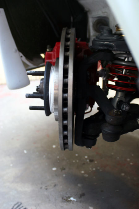

Hey, thanks Mats, now you must just make me feel better about the new brake set up with the m12 bolts shown a few pages ago. The more I look at it stronger it 'seems'. Brakes are on. I have moved the disc 12mm inwards(sits 3mm away from stub axle upright) and have 15mm spacer. All this just to run 15'' rims. Again if anyone wants to put these brembos on which have 'ears' , my tip would be to stay away. I do believe the bracket can be improved on by extending the bracket to a third point on the other side of the hub drilled through the other dust guard point. Definately no chance of failure as you have three m12 bolts attached to the hub and no longer a bending moment about the front of the hub only and also very little lever arm on the hub.

Well, i will see what happens next week. Here are some pics
See the gap between hub and disc. Soon I will also find out how much or if the hub flexes.
caliper bracket. Its getting 'stronger' every time I look at it. Its whole moment is about the centre(more or less)

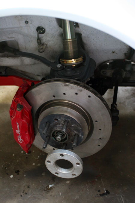

Pic of a 15mm spacer to go on so the bolts of the split rim will miss caliper. The widened origionals (2.5 rims)will not fit anymore which is sad as they are spares and still look great.

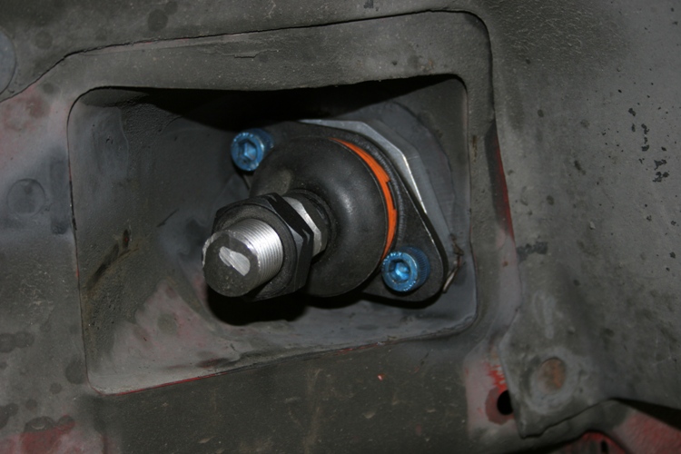

Have you considered converting the castor rod to ball joint? A simple mod compared to the other stuff you're doing.
Jes, I did it on my other car which has the custom made upper control arm. I found it quite a mission as the ears of the ball joint(105 series) did not fit and had to do some panel beating and metal stretching. Also the coring of the bigger hole took some time. So I just bought the polyurethane kit from performatek. If I laser a thick spacer for the ball joint to bring it away 6mm from the body I will do it or a ball joint with smaller ears by 5mm overall.

Hmm... is there a difference between the Milano/75 and the GTV6 here? I've done it on a number of Milanos and never found it a big deal. I use the alu spacer from performatek, and it centers nicely if you angle one corner slightly - no need to touch the car except for drilling the two holes per side for the ball joints.
This is not a good pic . The whole I cored was also offset to the origional hole which made it tricky. Maybe the ball joints i used were different anyway check it out.

And on the Milano... I do recall having to grind the ear of one balljoint slightly in one case, but compared to what else you are doing, this was nothing. The spacer is probably the difference as it saves you from having to enlarge the castor hole in the chassis, etc...
