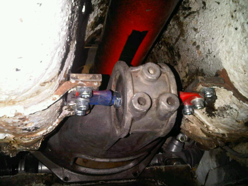

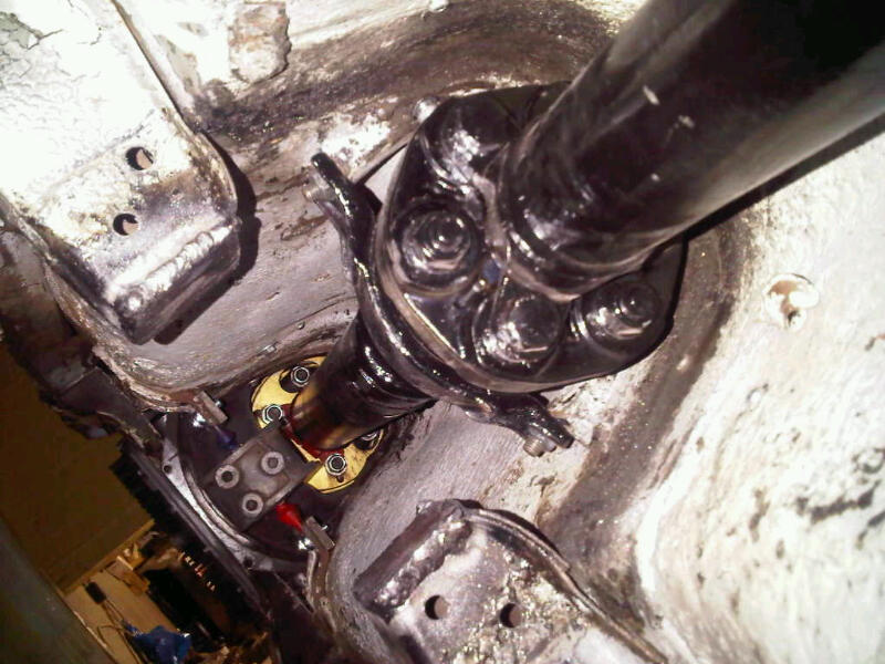

I figured you dont need a locknut as the motor cant rotate about the bell housing bush in above pic.

Kevin,
Hope this helps..
The engine will try to rotate as a torque reaction during take offs and gear changes. This you know.
It will also "pitch" fore and aft during acceleration and deceleration.
This is why this bush is so soft and fluffy from the factory. If anything, it should be a ball joint.
In your case, expect some harshness in the driveline and more vibrations generally.
Personally, I would lock up the fixing ends to the threaded rod with some anaerobic thread locker chemical and let the bush do its job. It either will or it wont. It's all experimentaion anyhow.
In my case, I use the modified bush as illustrated previously and I also use a solid rubber rear transaxle mount bush. These two combinations result in some harsh vibration resonance between 1 and 2000 rpm. Above that it is smooth. Fortunately, I don't intend to be in that rpm range other than in a serious fog..
Hope this helps..
Md , just because i had spare locknut lying around and to keep you happy I put it in
(I dont want an upset Ozzie especially with Rugby World cup approaching)

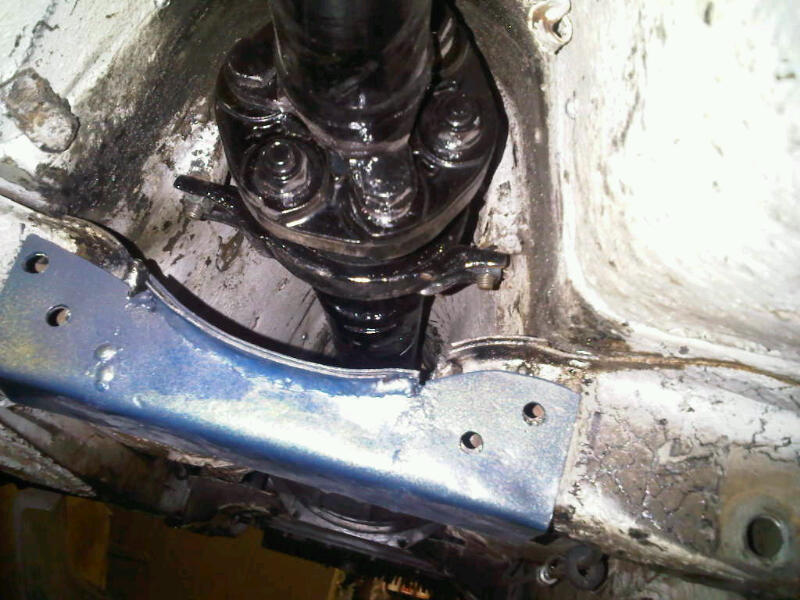

The prop takes all of two mins to take in and out with this centre bracket removed. I fyou still have torsions its another story. Unless you have the adjustable torsion bar set up which also takes 2 mins to remove and put back at same ride height.
Red paint on prop is my spline line so I can see if its lining up . I dont have anyone else to help me doing this so try make things easy for a one man job.

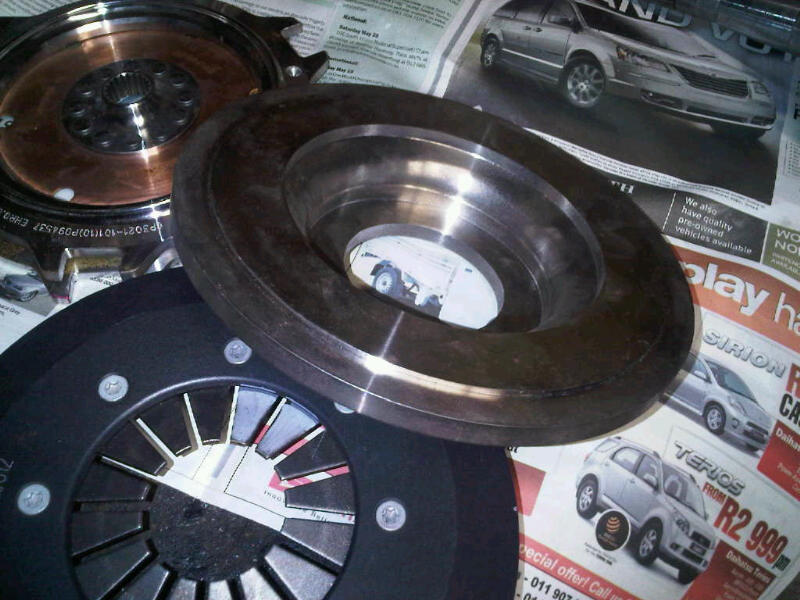

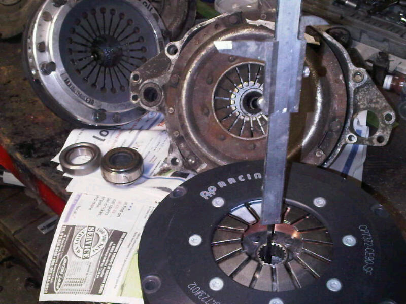

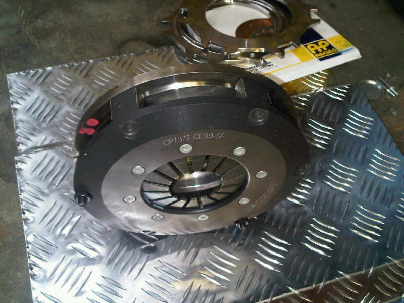

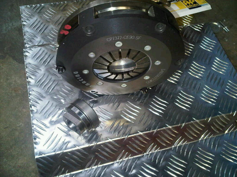

Continued from where i left off making a clutch flywheel and thrust bearing for my AP clutch. Here some pics. I have made the new flywheel to give a resultant distance of the pressure plate from the yoke to match that of the 2.0L GTV. The reason is I then use the same set up position of a push clutch of the 2.0 and I also use the same fork.
- raceclutch1.jpg (67.3 KiB) Viewed 7139 times
- raceclutch2.jpg (87.87 KiB) Viewed 7139 times
- raceclutch3.jpg (93.27 KiB) Viewed 7139 times
- raceclutch4.jpg (85.46 KiB) Viewed 7139 times
- raceclutch5.jpg (57.75 KiB) Viewed 7139 times

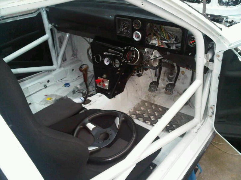

My interrior is nearly done but car still not on the track as im on to my second brake bias. it works fro one bleed then jams up. Im not sure if the seals inside dont like the Ap fluid or its just a kak make. I splashed out for an imported on but seams I must just make my own .

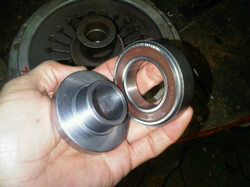

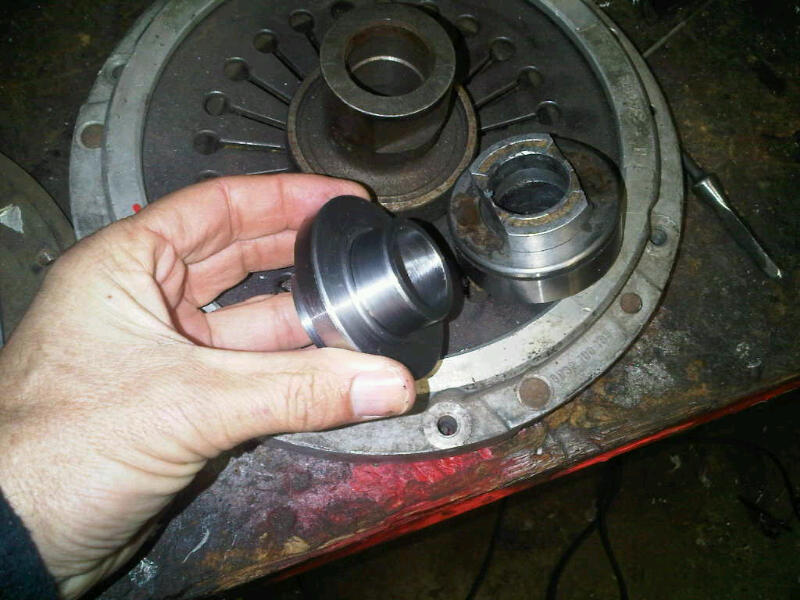

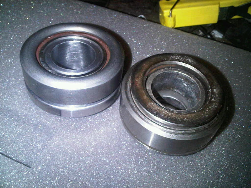

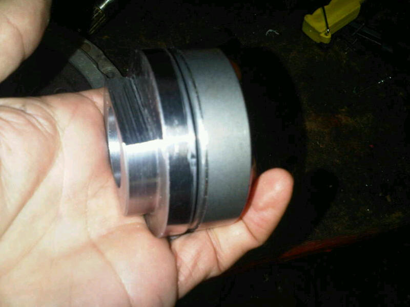

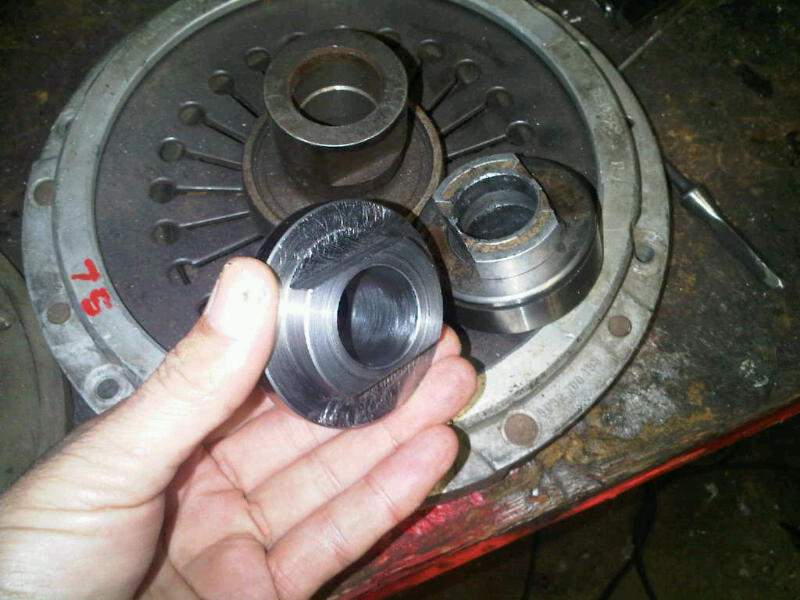

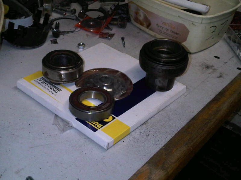

Finally finished thrust bearing assembly. The part i had was the actual bearing and "shell" from Ap . Note Ap use a convex shell not concave like alfa Due to internal diameter of bearing I had no choice but to base the new thrust bearing housing on the 2.0l with the 27mm shaft . So the entire set up can be a bolt in to a standard Alfa . If using a V6 all that changes is fork , pin, slave cyl, and input shaft tube to 27mm. No cnc drawings as i drew it on back of cigarette box of the machinist
. I left just a millimeter step so bearing does not touch face .
- thrust1.jpg (78.12 KiB) Viewed 7046 times
- thrust2.jpg (81.42 KiB) Viewed 7046 times
- thrust3.jpg (66.8 KiB) Viewed 7046 times
- thrust4.jpg (48.86 KiB) Viewed 7046 times
- thrust5.jpg (101.71 KiB) Viewed 7046 times

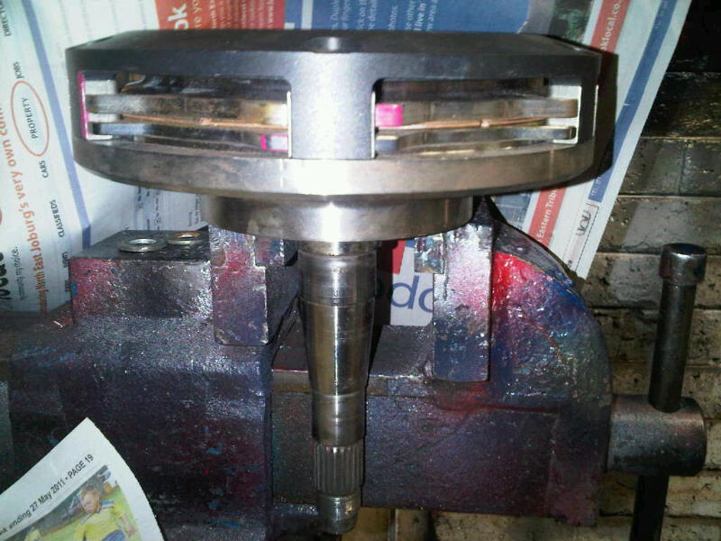

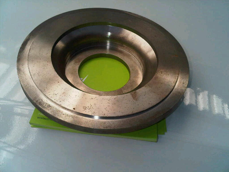

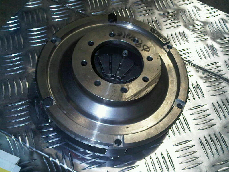

Some pics of the flywheel which is finished . Put some some slots in for the bolts .
- flywheel1.jpg (107.45 KiB) Viewed 7045 times
- flywheel2.jpg (89.63 KiB) Viewed 7045 times
- flywheel3.jpg (101.53 KiB) Viewed 7045 times
