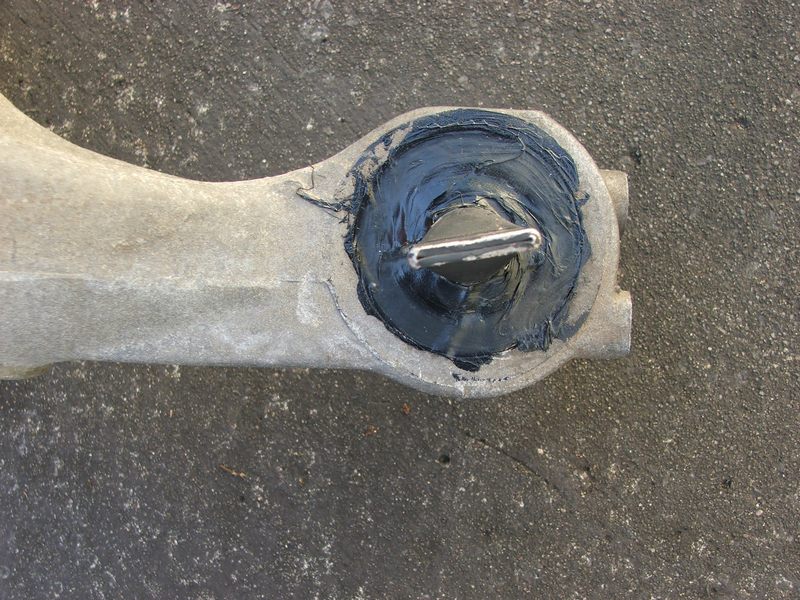

Why remove it at all?
Clean it down with white spirits to remove all oil contaminats.
Inject some polyurethane sealant in the voids and be sure the metal stay is centralised.
Allow to set before use.
Makes for a better mount than original for a race car.

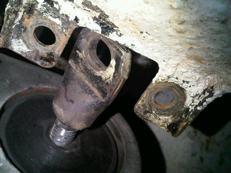

- Modified Rear Engine Mount Bush.JPG (138.3 KiB) Viewed 5920 times
Geez could not tilt this engine enough. The 24v cam angle sensor gets right up against body . Engine came out in 10 mins . Not lying as prop not connected and no brake booster.
Md the old mount is not symmetrical and I already had it packed with urethane from last year so it had to come out.
I am making new mount at moment with threaded bar etc so you can take the ears off which makes it so much easier when pulling engine in and out. Using 65 shore hardness rubber solid. If it's to rigid I will drill some small holes.

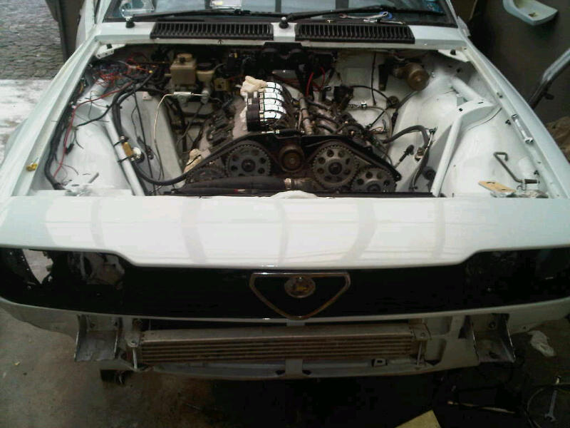

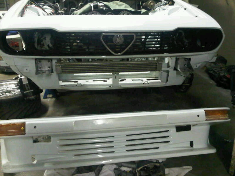

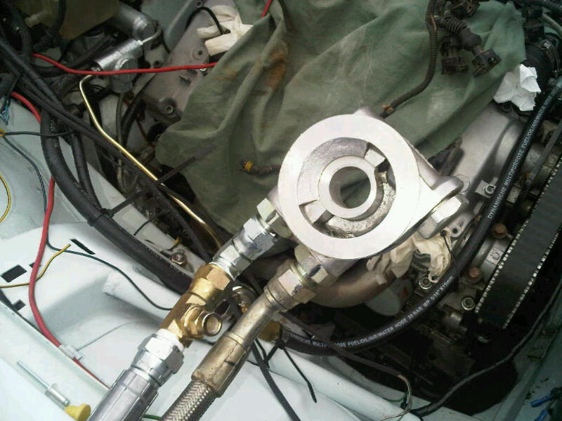

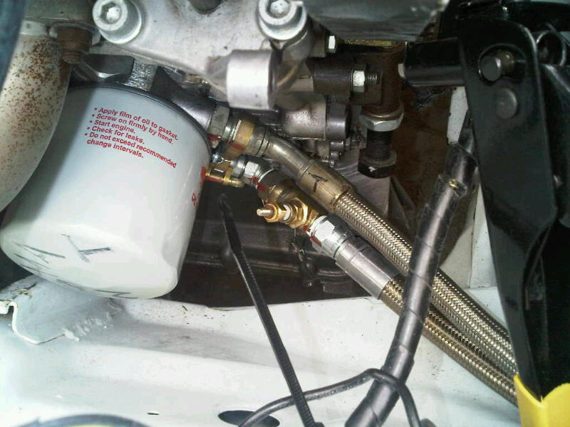

Some pics of my oil cooler which I have mounted in front which fit perfectly into my bumper/spoiler combo unit. Also put in temp probe on return line.
- racecaroil1.jpg (68.97 KiB) Viewed 5823 times
- racecaroil2.jpg (77.08 KiB) Viewed 5823 times
- racecaroil3.jpg (85.38 KiB) Viewed 5823 times
- racecaroil4.jpg (78.12 KiB) Viewed 5823 times

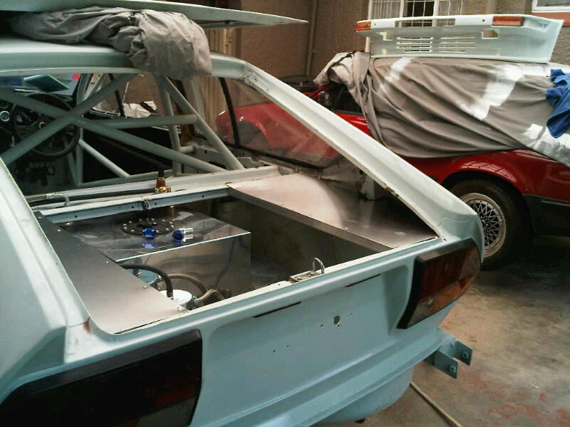

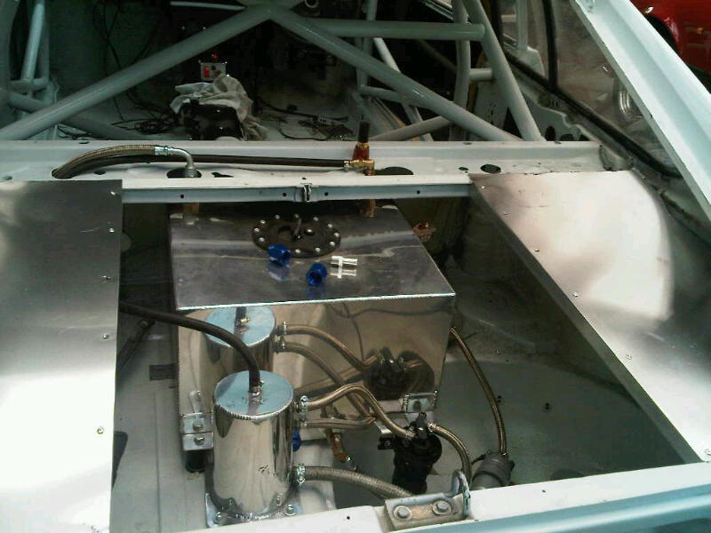

Its quite a mission to enclose boot section of gtv for FIA rules. My plan is to enclose noth sides with aluminium then use polycarbonate sheeting with a circular lid to full tank. Reason using polycarbonate is to be able to see if any leaks or problems.
- racecarfuel1.jpg (74.76 KiB) Viewed 5823 times
- racecarfuel2.jpg (86.51 KiB) Viewed 5823 times

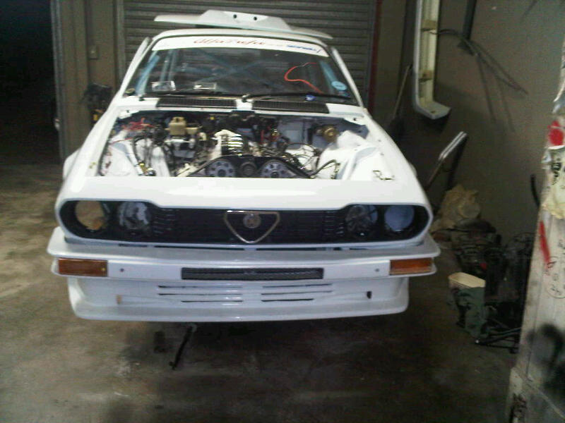

Front ucombo unit on with airduct to oil cooler. I will run my number plate over this when I drive to track.
- racecarfront1.jpg (70.81 KiB) Viewed 5822 times

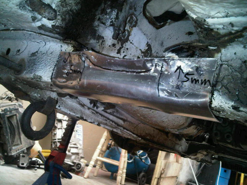

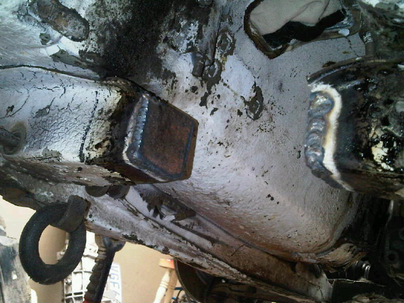

Decided to cut the center section out in tunnel to make it easier when removing prop. I then use a nother section which bolt back with four bolts. Pic of template which i will weld up with mild steel .
- racecartunnel1.jpg (103.16 KiB) Viewed 5822 times
- racecartunnel2.jpg (98.15 KiB) Viewed 5822 times

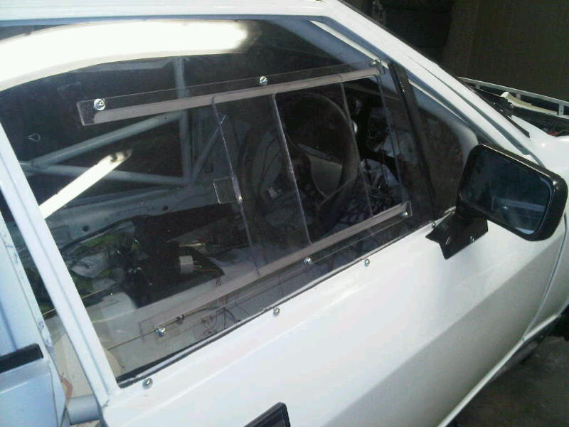

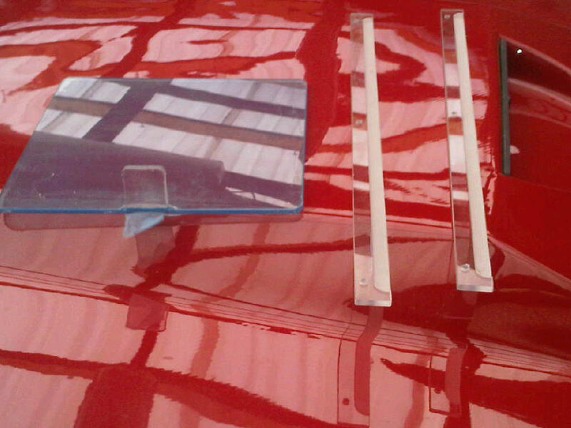

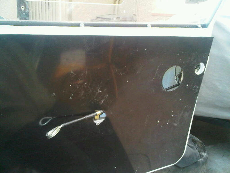

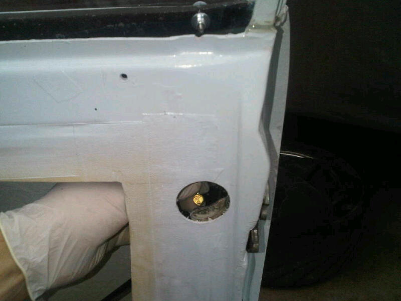

Some more pics of progress . Used cables to open doors as its only way with fiberglass doors. no place to put handle anyway . Also made a sliding window by milling two flat pieces of polycarbonate . You got to space with washes so it does not scratch to much. See pics
- racecardoor1.jpg (46.06 KiB) Viewed 5795 times
- racecardoor2.jpg (54.79 KiB) Viewed 5795 times
Window pics
- racecarwindow1.jpg (71.21 KiB) Viewed 5795 times
- racecarwindow2.jpg (65.62 KiB) Viewed 5795 times

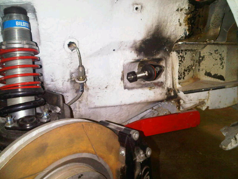

I made some spacers for castor arm but still had had beat the bodywork to get it to fit. As mentioned I did grind of ears to get a bettter shape.
- racecarcastor1.jpg (80.15 KiB) Viewed 5795 times

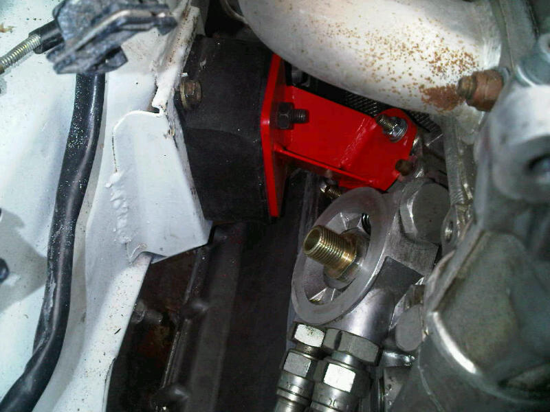

Thanks to this forum(Brian ) for advising how to put bush back in but had to laugh. So I froze the bush to -2 deg in freezer whole nigh then got my heatgun and heated up up bellhousing to 60 degrees. I then put the bush in with 'huge ' clearance but was so taken back that while admiring this ,the rapid warming of bush was faster than me pushing bush 100 % percent into position so its in 98% which i will live with.
Thanks guys.
Pic of bellhousing bush . I moulded a threaded tube into 65 shor hardness rubber with two adjustables ears .
Thanks guys.
- racecarbellbush1.jpg (87.06 KiB) Viewed 5795 times
