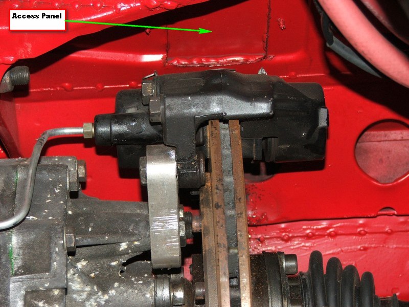

Here is a closer look at the access to the brake pads, convesion plate and rear vented 300mm rotors.
Access Panel.jpg (121.04 KiB) Viewed 8313 times
