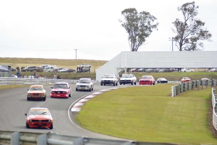

It's been a while....
Here's the Brick hard at it at Lakeside running in 2nd place at the time..
