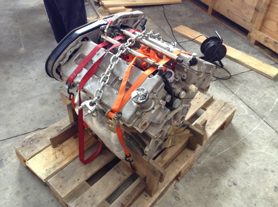

I packed car and spare motor today in container which will arrive in few months time to UK .

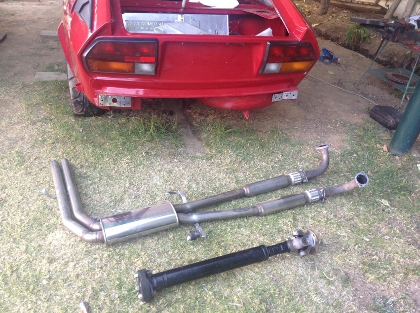

In meantime I will make another prop for the car as the universal I used came back to haunt me . Domingos from Powermods ( 155 TT and 3.7 widebody TT) warned me he could never get the universal with the sliding joint combination vibration free on these cars front mount cars . Silly of me to try prove him wrong . Vibration comes in at 120km/h whether engine is on or off .

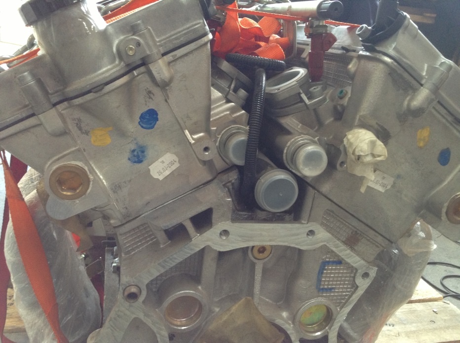

Note the spare new gta motor I had in storage still has manufacture date on it .

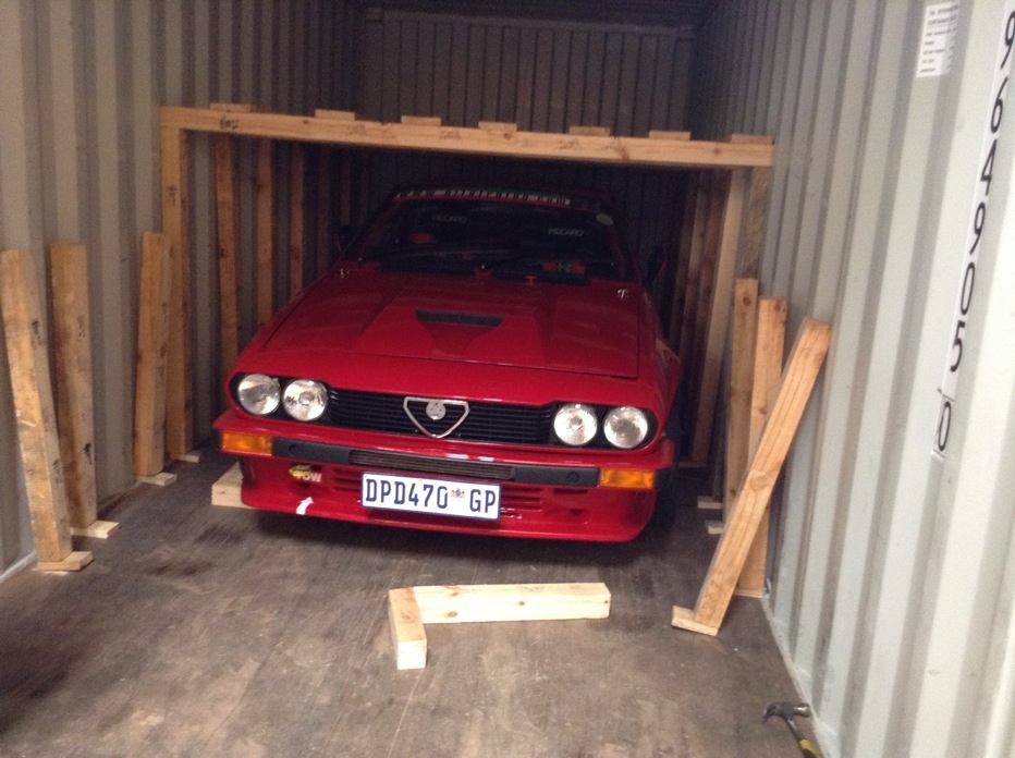

Nice one Kev, seems to me you are going to be there permanently. Btw since i read europe is being hit by several storms, i wonder if lining the roof and doors, fenders, etc with styro foam or thick sponge would be a good idea, just in case the weather gets real rough and the car moves a round a bit tooo much and hits the wood.

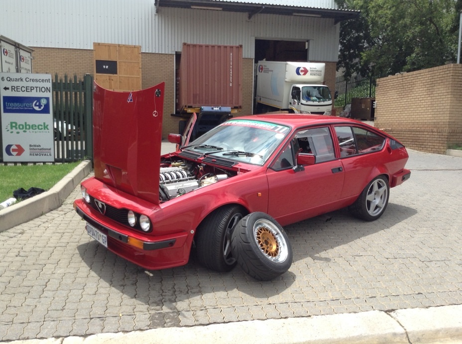

Container should be ok . I had one piece of wood that came lose last time but their were no problems . There are couches and furniture for another customer going on top of the car hence the platforms being made .
The guys who do my loading are British International Removals situated in Limbro park in johannesburg . Can't really see but there are two Porsche Targas that are going to be loaded .
I managed to load 7 speedline rims and I'm looking for one more as in pic if anyone knows where I can find another one .

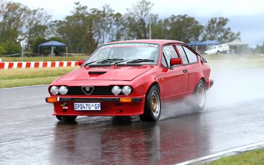

I found a pic from the race meeting at swartkopz in SA (2014 /02/01) ust before I loaded the car . This pic was taken qualifying in rain but session was stopped due to oil on track . Am I imagining my rear wheel has air under it . Good illusion .

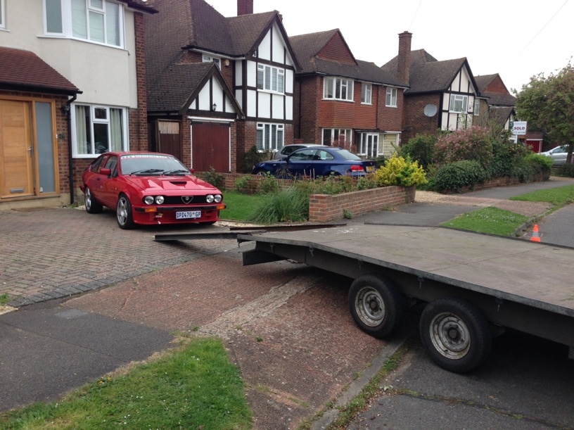

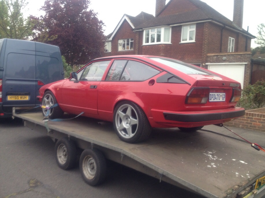

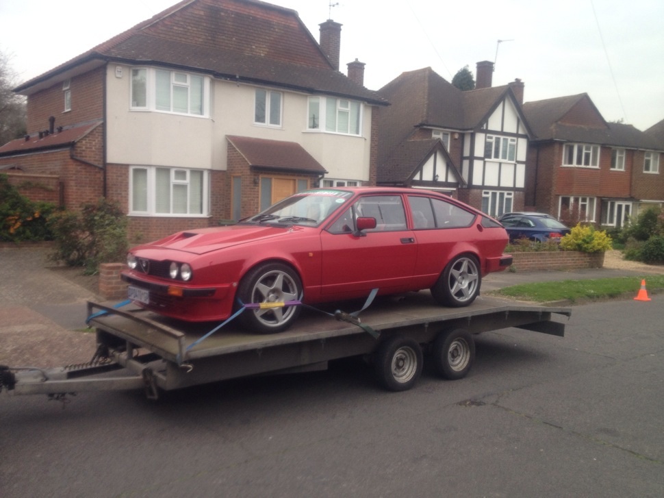

Some pics of arrival of car in UK. British International Removals doing great job again .

This project will still continue as the car has still a few niggling areas . I really want to get it perfect . We'll one area was not really niggling but actually a major problem that prevented me racing at Zwartkops at the International in February . Even though qualifying was great fun the speeds in the wet we're not high enough to highlight the huge vibration issue . Whether the engine was switched on or not , in gear or neutral it was bad about 120 km/h onwards . Did mention before even changed wheels but the larger 17 " just made the problem start at a higher speed .
So looking at pics of the prop and doing some research I think I have found the problem .
From the pic you can see it's not a typical prop for a front mount gearbox as the Alfa sei has and extended diff tube . This makes the prop in ONE section not in two sections as per your normal BMW etc .
If you have one UJ and the angle is greater than 1degree out of alignment we all know at constant rpm the UJ will speed up and slow down due to the arc in the path the joint rotates through . So when you have two UJ in a prop and the input and output angles are equal the speeding up and slowing down or call it phase is balanced by the other UJ as long as they are lined up correctly .
Therefore if I look at my prop even though it's perfectly in balance and that cv is designed up yo 8500rpm it can never work unless I some how get the diff and engine perfectly in line . This I can't do as the Alfa Sei diff is offset and this will require big mods to the dedion .
The standard prop on the Sei uses two rubber donuts ( couplings) hence no phasing problems .
My only logical solution at this stage would to be to use a CV joint at the rear .
This YouTube clip makes you understand the phasing problems in a UJ prop .
http://m.youtube.com/watch?v=DDmz0tibVGM
Any comments from the gurus , am I on the right path ?
