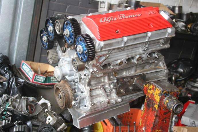

off topic, but engine nearly finished!

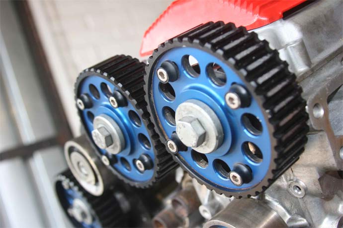

A couple of questions:
1) Are those upper A-arms from Nick Humphries?
2) This is a 3.7 24V?
3) The cam pulleys have 4 extra bolts and the cam gear are slotted? Is this for added clamping force instead of relying on the single tapered end of the camshaft?
Impressive, especially the upright!

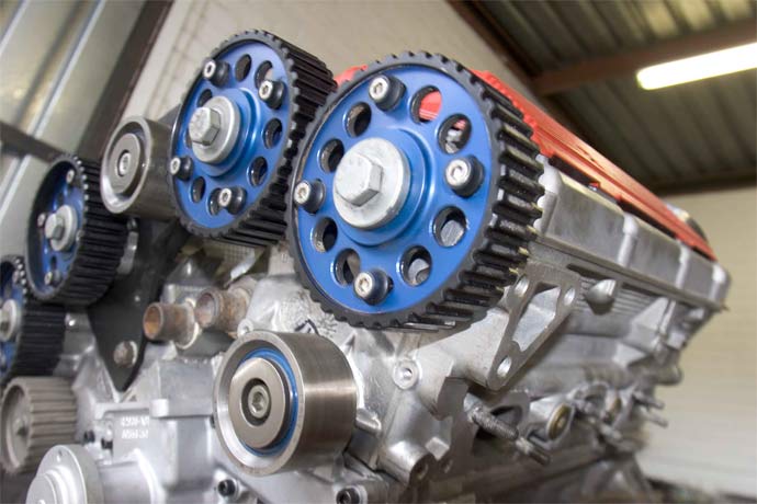

Thanks Z!
1. No. Nick has had pictures of similar arms on his website a long time ago, from a customers 75 evo racecar. He may have made a copy, but i'm not sure as he's no longer trading, i believe. These were from Alfa75 IMSA racecar.
2. Yes, 3.7 full race engine. Development cams, 1 off Jenvey t-bodies, specially made with carbon airbox, and so on.
3. No Z, this is only for adjusting the cam timing quickly, it has a degree scale machined into the pully for +- 10 deg.

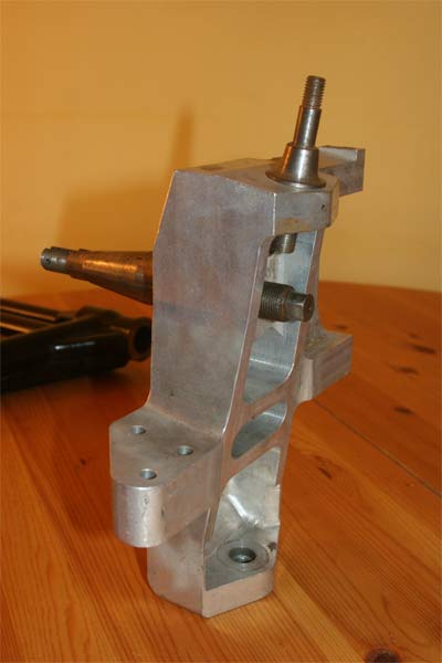

4. Upright is very special. Improved camber gain on compression, very light and strong, adjustable steering arm ratio - so you can get very quick steering and use power rack, oversize bearing in the billet hubs, adjustable anti-dive with lower arm.

Very Interesting parts Andrew, I take it the upright is hollow from behind?

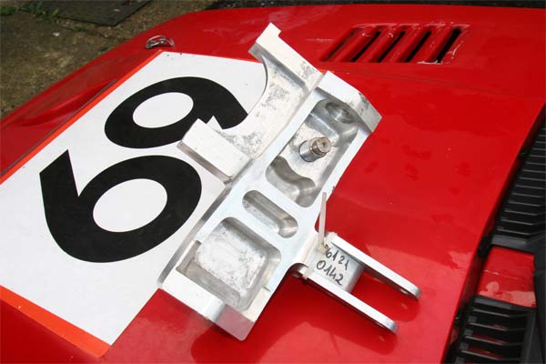

Torsion bar splines in the lower arm? That's not right is it? :?
Very cool stuff anyway. :D
Andrew.b
Posts: 205
Post by Andrew.b »
Mats wrote:Torsion bar splines in the lower arm? That's not right is it? :?
Hi Mats
Hey thanks man.
All the factory 75 evo/imsa used this bottom arm as far as I know.... For some reason the splined section was left on for whatever reason, possibly the same arm was used with torsion bars from the earlier 75 turbo racecars?
I have pictures from several factory race 75 turbo that all show the same arm............ any ideas mats?? have you any factory cars in your neck of the woods?

la_strega_nera wrote:Very Interesting parts Andrew, I take it the upright is hollow from behind?
With any luck I should have some photos of Mid 90's Ford V8 supercar front suspension arms/upright, all beautifully fabbed steel....
I should dig out and scan some of the pics of got from an article on the 155 DTMs... special is not the word.
Ben
You are correct Ben, hollowed out for weight saving.

Those lower arms are pretty interesting. Im impressed with the quality of construction and the retension of the torsion bar. I was thinking it wouldnt be too difficult to make an insert out of the spline part of an old lower arm for using in a fabbed one. Glad to see it can be done. The brace from the spline along the lower part of the arm shows it was clearly designed to be used with the torsion bars at one point in time. On the uprights the stock alfa wheel bearings seem whimpy. I was thinking if one goes to the trouble of making a whole new upright then perhaps a live spindle would be neat. Get the bearings away from brake heat too. Also, most new wheels allow moving the brakes a lot further outboard wich means the arms could potentially be lengthend somewhat. Something else I was thinking for those who run torsion bars is replacing the bushing with a bearing of some sort. That bushing is under huge load and therefore adds a lot of sticktion plus wears pretty fast. A bearing could be incorporated into a new lower arm design.
Ahhh, coffee and keyboards.
-Tom P.
A fabricated lower arm together with a torsion bar sounds pretty difficult. The whole load would need to be transmitted through the arm and that means it needs to be beefy :shock:
