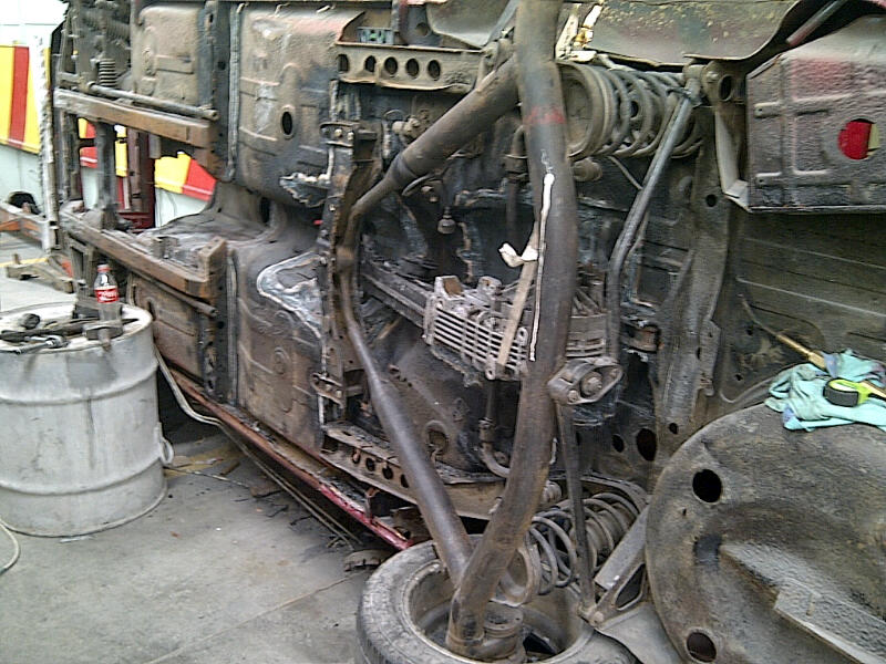

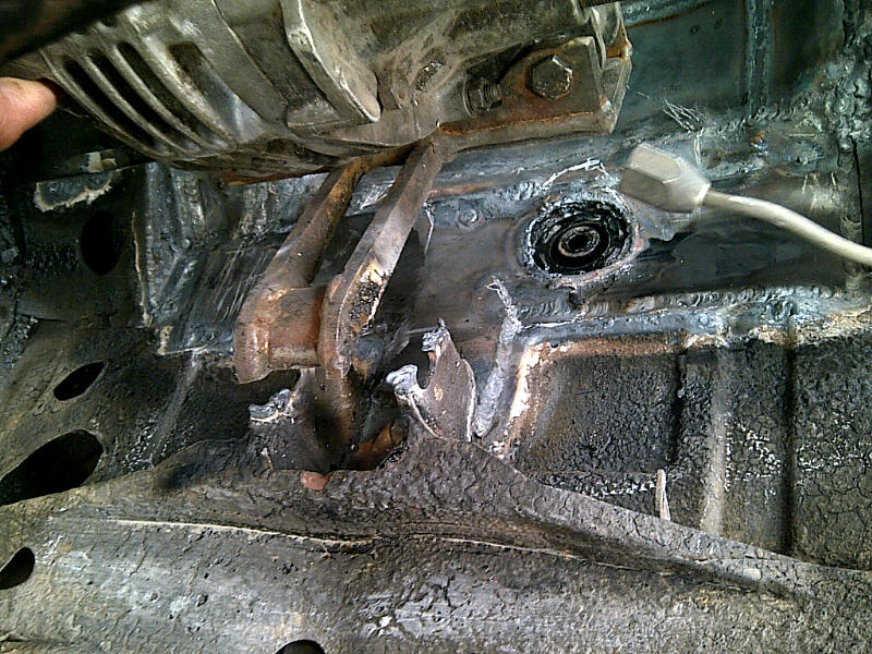

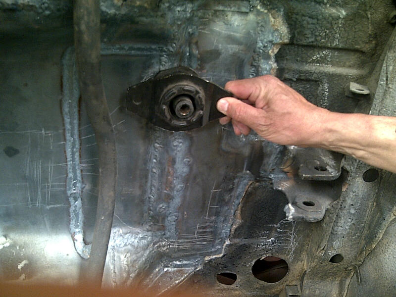

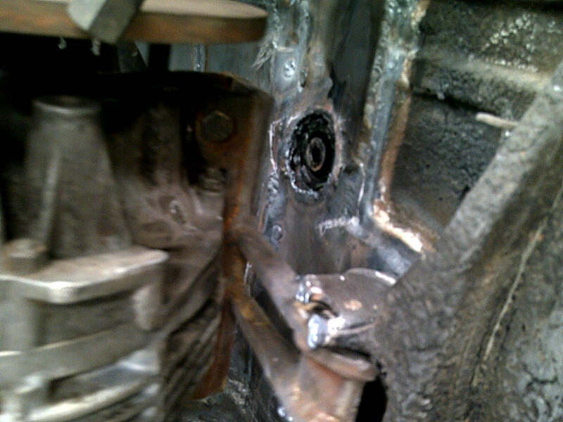

Some more updated pics.
More pics
and more

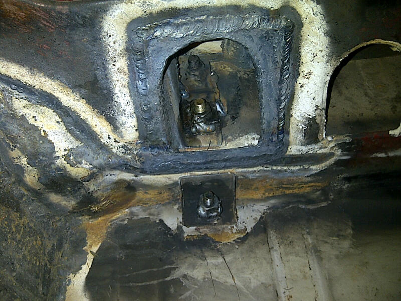

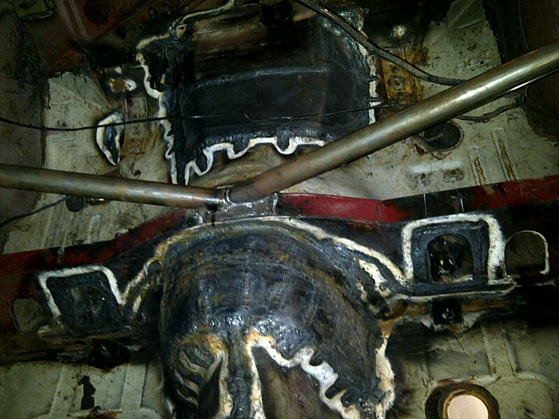

Mounts

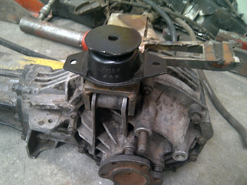

The mounts will be cut in from the top so the diff will hang . You can adjust the height of diff depending on lenght of the bolts. The rest of bracket off once its all in place then neaten up.

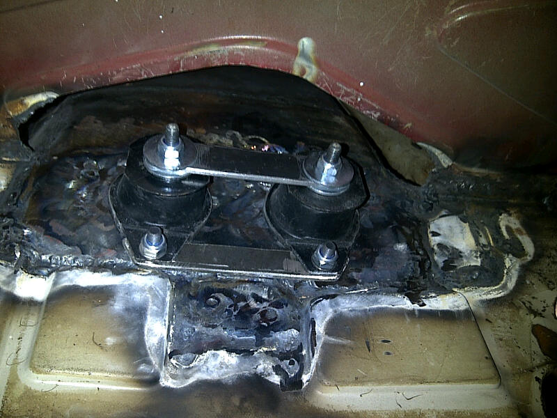

Pic of diff mounts in rear . the diff height can be adjustable by putting spacers in with longer bolts if necessary .

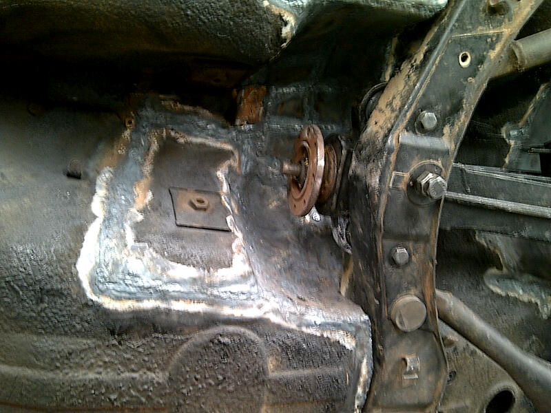

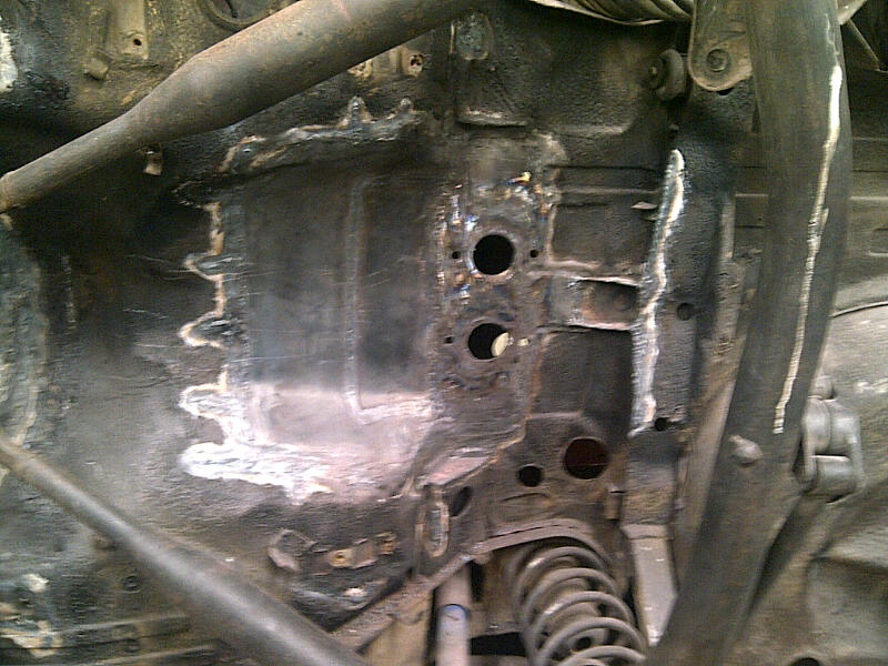

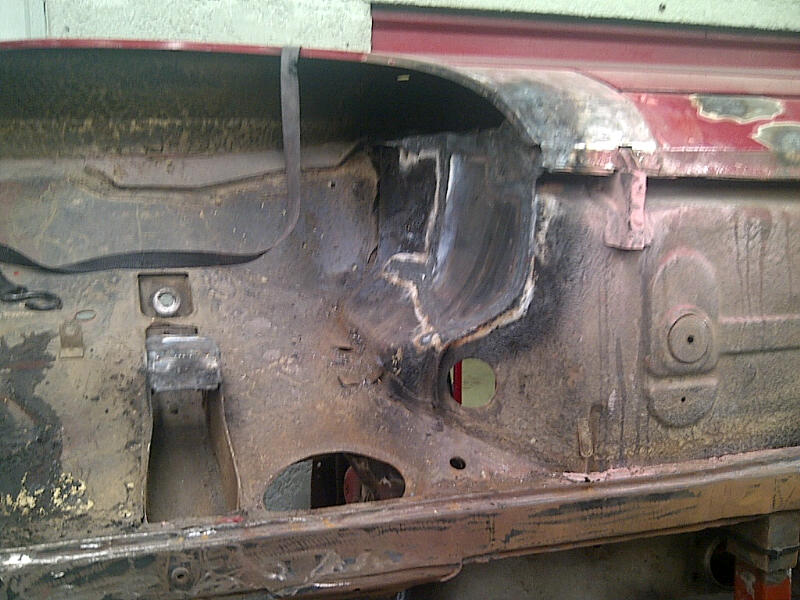

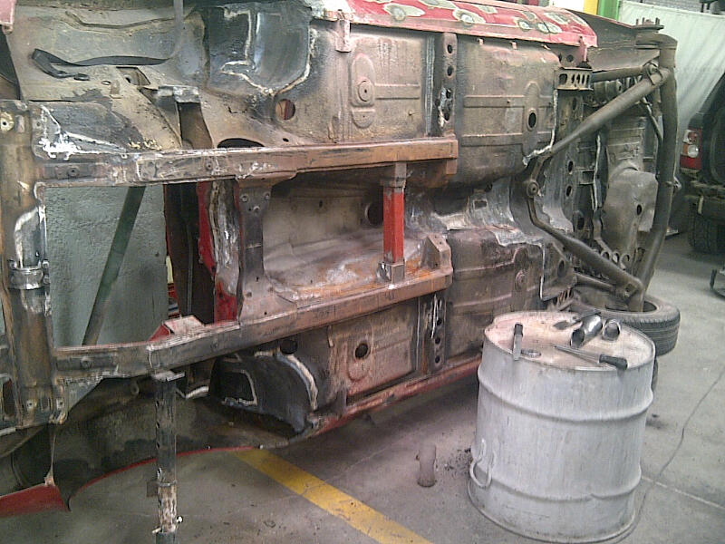

Some update pics. Cant see much change but been doing a lot of cleaning of welds and also bring the front inside arch back 30mm as this always got in way when fitting wide rubber . Also cut bump stop shorter for the coil over to clear better as these bilsteins were going to have much longer travel than the RS .
