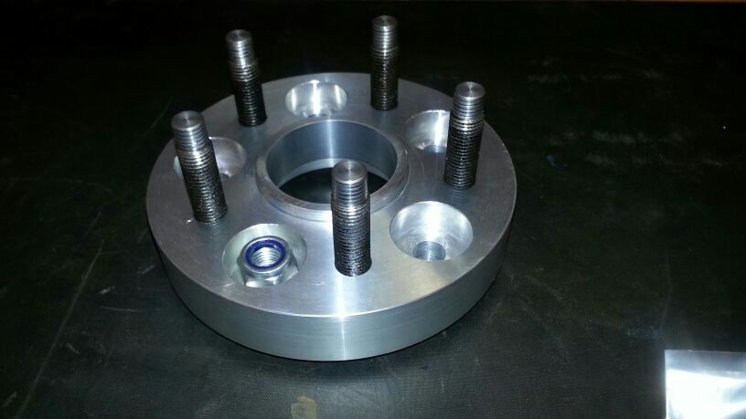

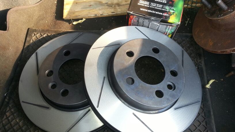

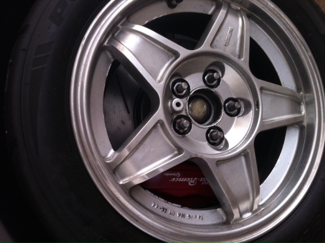

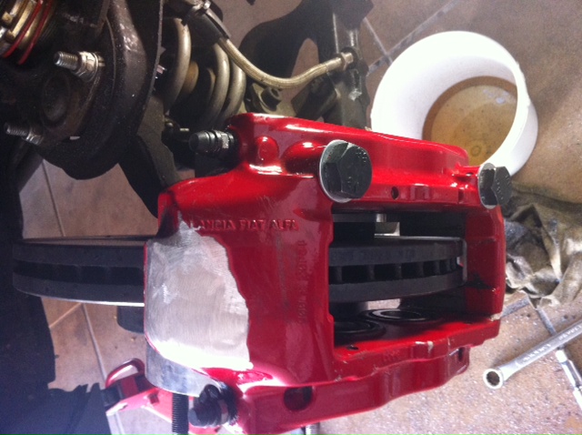

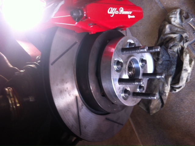

Below find some pics of the Brakes Upgrade done..
4 pot Brembo, 308mm disks, 29.5mm wide.... AND they fit under a 15" Rim!!!!!!!!!... and does it stop!!!!!!!!
spacer used
spacer used
4 pot brakes 5 spacer.JPG (46.34 KiB) Viewed 14143 times
View thru the wheel
View thru the wheel
4 pot brakes 1.JPG (110.03 KiB) Viewed 14143 times
front view
front view
4 pot brakes 2.JPG (99.89 KiB) Viewed 14143 times
Top view - had to "file" a little bit of caliper... but not bad
4 pot brakes 3.JPG (124.96 KiB) Viewed 14143 times
disks BEFORE fitting, sloted and hardened
4 pot brakes 4.JPG (73.54 KiB) Viewed 14143 times

-charles-
Re: A new GTV6 2.5 entry into SA Marque car catergory
Looking good , nice to see the spigot on spacer . . Which pads you using ? Looks like the box is EBC blue . Its least now you have the stopping power for that motor of yours . Just remember when they balance the wheels to put the weights near outside as they could catch on caliper .
