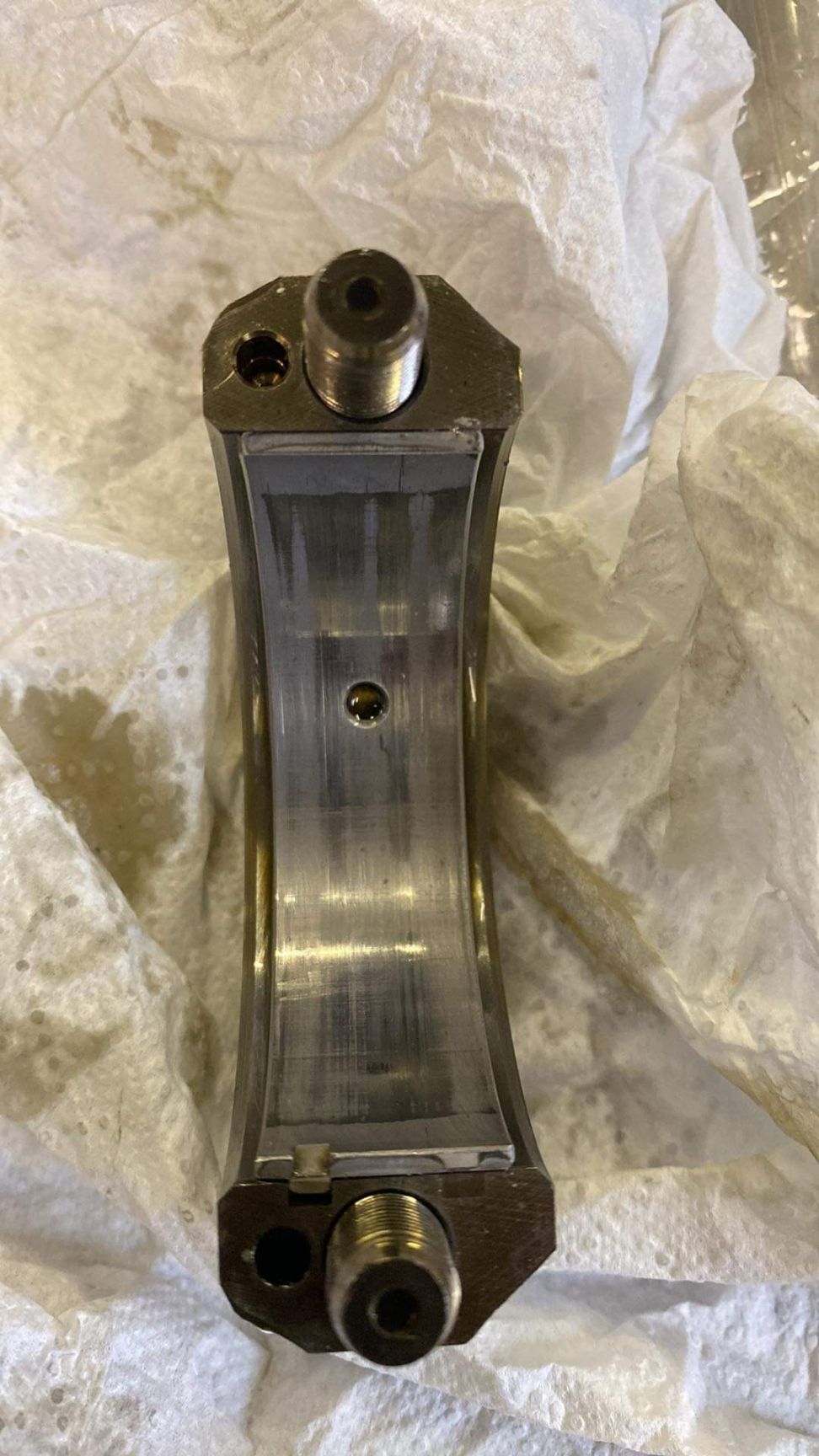

This is how big end bearing on cyl 6 looked like:
Actually looks much worse on the photo than in real life, the surface was smooth. Nonetheless, decided to go with new set of bearings just for the peace of mind.
The oil starvation issue really discouraged me to do any events later that year, so this was first on the table.
