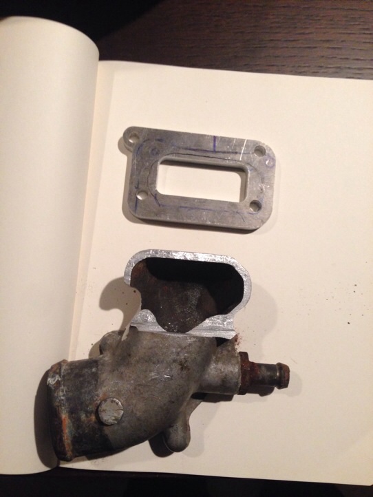

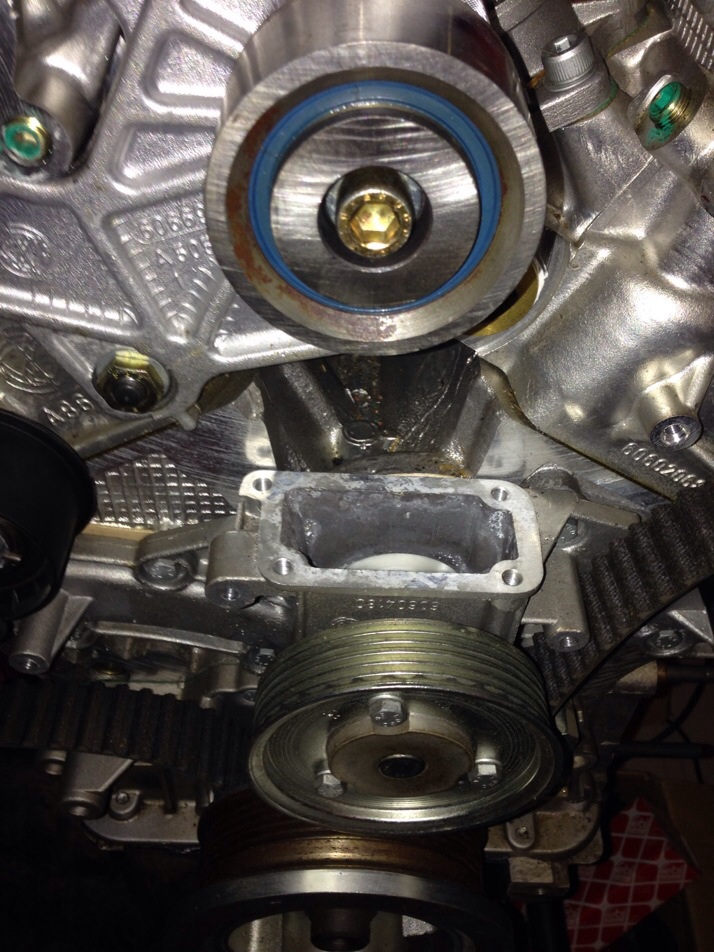

Hi Daryl , the 164 water pump cannot fit on the later 24v motors . However their is a solution like Wolfgang showed by modifying the thermostat housing to fit . I found it was a lot easier to laser cut and entirely new flange with extra wall thickness as the 12v housing needs to be positioned about 12mm further away and 6 mm more to the left . This allows you to then machine it out once you have welded It up to get good water flow again .
I made a few of the these water pump conversion thermostat housings a while a ago . I will have to have look ig you're still interested . Drop me a pm .
The pics will show how the top of the housing has a different shape and bolt centre to the 164 and 116 series 12v type . Only one hole matches and even then it's still as mentioned above way out of position .
On the newer 24v motors the idler pulley is much lower than on the 164 to give more wrap of cambelt around the pulleys and hence this would interfere in the thermostat if was in the front .
Pics show newer 24v motor water pump and 12v conversion . A newer water pump gasket shows the difference in the pic .
It's so much easier to bring the water out the front than bring the pipes around the back of engine as it's a nightmare if you want to change thermostats or fix any leaks as you need to take engine half out as their literally no space when mounted in the GTV or 75s . Obviously so much easier in the fwd cars . Also if you skim the heads to a much higher compression over the 11:1 mark the heads get closer which affects the fitment of the original water pump housing set up .
