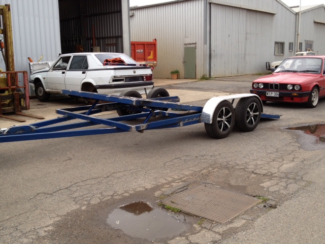

and the car trailer ive been building. tilting so no need for ramps
the beamer is my daily car atm untill my gtv6 is resprayed and 24v installed...
