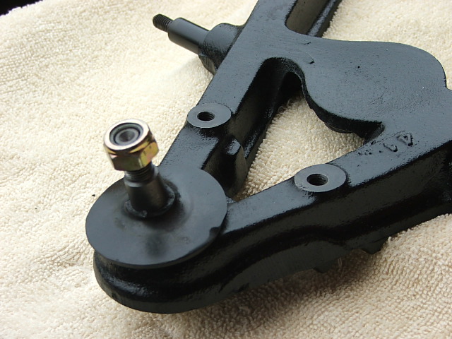

I am paranoid about welding the uprights and that's why I use the BJ conversion instead. Here's a photo of it.
However extending the bent arm for the original ratio I would consider. I will give that some serious thought !
The upright is reamed in the opposite direction and a sleeve installed for the fit.

The BJ's are from a local common car now out of production.

- Ball Joint Pressed into LCA under tension.JPG (117.42 KiB) Viewed 8594 times
- Close up of BJ in tension position.JPG (126.16 KiB) Viewed 8590 times
- Dust Cover to Ball Joint.JPG (116.32 KiB) Viewed 8591 times

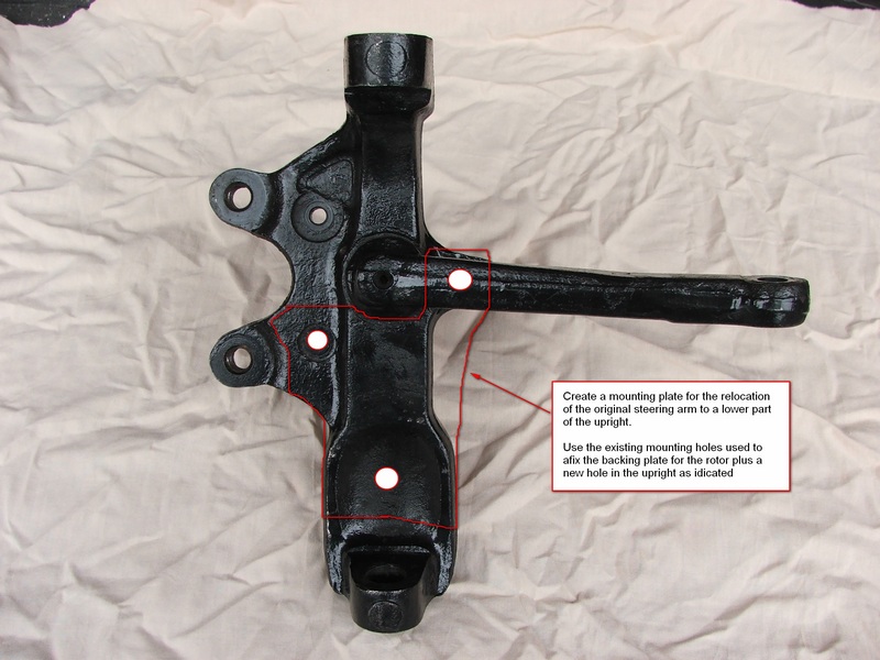

Thanks Micke. Good to know that the shorter arm still does the job. I must confess that using heat and bending the arm to a precise location so that you get less than 15thou error is a big ask. As Mats says, minor changes make a big difference so to do this is a bit like taking your appendix out via your arse.
Sure it can be done but the job stinks..
It would be great to set up some parallel arms and be able to move the connection up and down by shimms to locate the exact position required.
The lesser option is relocate the arm lower down using a transfer plate.
I got some ideas of how to do this but I cannot use CAD. If I put the photos up with the instructions on what to do, can someone draw it up so we can share the idea properly?

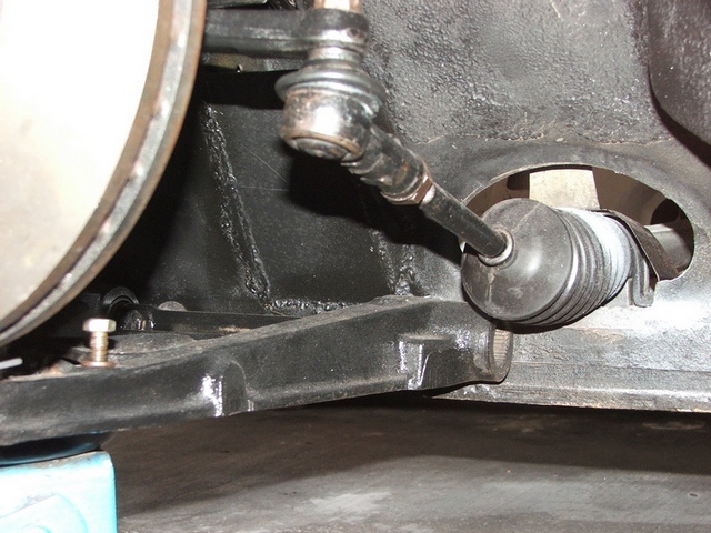

Here's the set up on the Brick
It has a weld on the upright that I dont want to repeat. See green arrow.

Here's some photos of what I have in mind and as I said in a previous post. If someone can do a CAD drawing of the idea that would be good.
The photos simply propose a relocation of the arm by using a conversion plate. A better idea maybe to retain the original arm and add a second one with a fixing between the two so a tie rod could be positioned there and shim up and down for adjustment?
- 1aAlfetta Upright.jpg (146.03 KiB) Viewed 8507 times
- 2aAlfetta Upright.jpg (141.51 KiB) Viewed 8507 times
- 3aAlfetta Upright.jpg (145.94 KiB) Viewed 8509 times
- 4aAlfetta Upright.jpg (102.44 KiB) Viewed 8507 times
One more photo to make sense of it..
- 5aAlfetta Upright.jpg (142.09 KiB) Viewed 8507 times
