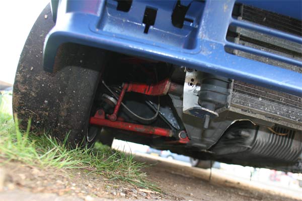

hmm light,wide track,upside balljoint... i like it verry much :D if its no secret what kind of lenght adjust will you use?
somethink like this?
giulieta turbo adj Aarm.jpg (37.78 KiB) Viewed 11455 times
No secret. Rod ends, quite like your picture.
