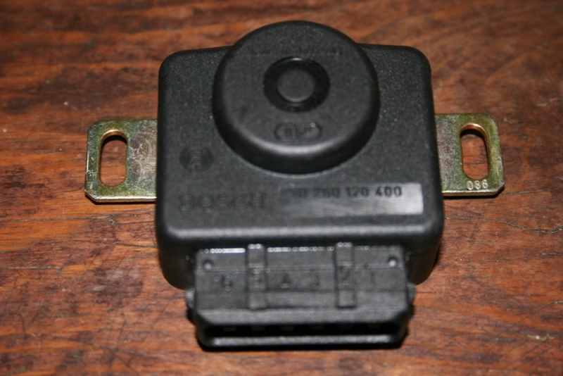

It is off the 944 Turbo, nut "regular" 944, if I recall correctly. I have that Bosch TPS in my drawer, never got around to use it, and car long gone. I can read Bosch number off it if you are interested in cross-checking. Mine is surely a potentiometer and not the on/off type.
A pic attached. In case you can't read the number: Bosch 0 280 120 400
It has 6 pins. I could not find my notes from measuring it and identifying the pins to use - you would have to do that.
- BoschTPS.jpg (171.71 KiB) Viewed 16118 times
