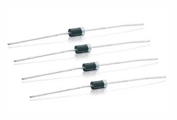

I used a 2.5Amp 1000v Recrifying Diode ~ Radio Shack PN 276-1114:
Note that the silver band indicates the direction in which the current will flow, so the lead closest to the band points to the relay.
The coils only start firing when the starter is engaged and I can confirm that the engine keeps running once the key is released.
