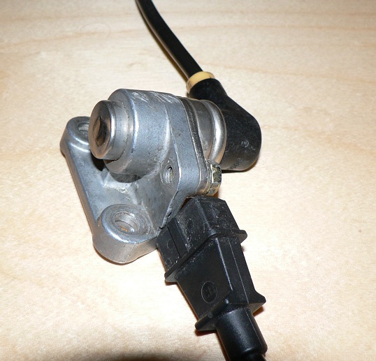

So the folks at Gotech think that the air gap is too large between the toothed ring and the crank position sensor. It is actually 0.8mm. Only one of the green lights on the ECU flashes when the engine cranks - apparently a sign that the CPS is faulty since when all is well, both flash.
Looking at the CPS, this seems reasonable as it is mangled:
Alfa 164 LS Crank Position Sensor
The current CPS is:
BOSCH PN= 0261210
