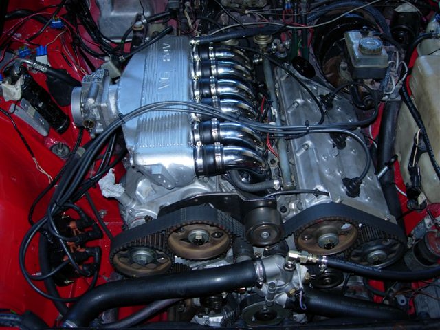

We have been able to start my Alfa that we converted to a 3.0L 24V. We are using the gotech pro and we basically hot wired it to start it. We put the red wire for the power for the gotech box to the Ljet old relay and we grounded out the black wire for the gotech box. We then had power to the box. It was alway on so when you turned off the ignition switch the engine stayed on until we pulled the red wire. We also put the fuel pump power line to the hot wire of the Ljet old relay to have power. We put another relay between the hot wires of both the fuel and gotech box just in case there was a short. As I stated before, the Alfa Started right up.
Now, we are puzzled what would be the best way to permanently hook this up so that the ignition switch will do this for us. Is there anyone else who has done this already. We have the manual but we are not good at electronics and need some suggestions. We are planning on having our Alfa Mechanic look at this but I would like to let him know what the forum suggests and well. The reason being is that he maybe unfamilar with the Gotech system and my 3.0L 24V engine. I am just guessing this though since he recommended that I not do this conversation.

I installed a Gotech in both a GTV6 and Milano. I did away with the combo relay and all the L-jet engine compartment harness. I used a standard bosch type relay with double pin 87 ( not a 87 and 87a). In the remaining connector from the combo relay, you will find the wire for fuel pump, and a switched voltage wire. Use the switched voltage wire to turn on and off your relay. I used main power for the relay straight from the junction box. hope this helps.

Thanks for your post. Just to clarify my understanding of this. The Relay consists of two black boxes. There is a right box (Drivers side) and a left box(passager side) They are right next to each other. The relay mount is mounted to the left of the windshield wiper mechanism. We removed the right box and are only using the left one. This is looking at the boxes from the front of the Alfa. As a temporary set up we "Hot Wired" the system just to start it up to hear the engine using the left box only. I am assuming this is the pin 87 relay that you are referring too??
I was thinking of using the pink wire to for the power to the go tech. I have not spoken with Roger (Mechanic yet to get his opinion). Is this how you did this? Also, do you know what each wire represents on the left relay. I have a Manual but I do not know how to read this correctly. This is the Manual that is supose to be for the Milano GTV6. It looks like the wiring is for the milano though. Maybe if you have the same manual you can direct me to the page number. My understanding is there is a car disk and this Manual for Mechanics. I am just tying to understand this set up for my own eduction since I am very ignorant when it comes to electical stuff.

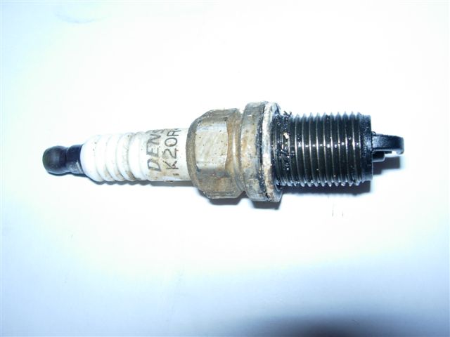

BTW, something looked strange when I was changing the spark plugs - Cyl 3 had some calcific deposits around it and some on the spark plug body (Near the ceramic portion). Looks like some water / coolant was in the spark plug well but not in the cylinder (Coolant levels was a bit low and had to be topped up - no oil in the coolant observed)). Cyl 2 had lots of oil in the well - I presume the seal between the camshaft cover and spark plug well isn't sealing well.
Spark plug tips - 1 was burning well; 2 and 3 had black sooty carbon; 3 , 4 and 6 was wet and quite sooty as well. I have the Innovate LM-1 but the readings prior to pulling the plugs out were very inconsistent. At low revs it was reading between 15-18:1 and higher revs was somewhere between 12.5 and 13. Adjusted it close to 14.7 at idle/low revs but the plugs indicated too rich a mixture??? Could the sensor be faulty? Will try to take a pic of the plugs - I think I threw them out.

If you can,run your car..Then remove the plugs and keep them in order of removal..take a pic and post please..It sounds like the same hassle I went through for FOUR months before finding the problem..

Couldn't find the other plugs but here's a few pics of the Cyl no. 3 plugs. Doesn't look good at all. I have a new set of NGK platinum plugs but didn't want to put them on untill the engine is running better. Had a set of Nippon Denso K 20R-U but have now put a set of NGK BKR6EYA.

- Note the calcific deposits, how did that get in the plug well?
- Cyl 3 Plug.jpg (27.97 KiB) Viewed 18458 times
- Cyl 3 Plug.2.jpg (31.66 KiB) Viewed 18455 times
- Cyl 3 Plug3.jpg (43.15 KiB) Viewed 18454 times

Brian,that plug has oil...If you can remove the exhaust manifold and check for wet oil...bet you its covered..actually,wipe a finger in the tailpipe..rub fingers together and see if its all shiny and oily..
A rich mixture will be sooty but DRY.!
