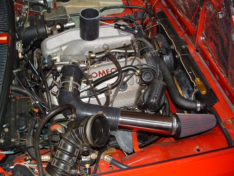

OK, this is the beginings of my GoTech intake, I am going to make two, one for my Verde and one for my GTV6. The Stainless Steel between the TB and the elbow is where I am going to weld some ports for the vacuum lines, also the hole for the gromet for the Air Intake Temp Sensor. The air filter is my current one, too small for the 3" pipe, and I am going to cut the pipe down between the elbow and the Airfilter, I think I can get both out of the SS pipe I already have. I found out the ports I bought are too big, so smaller ones are on the way, plus I am waiting on injectors, so soon I will hopefully fall under the "Success Story" header...

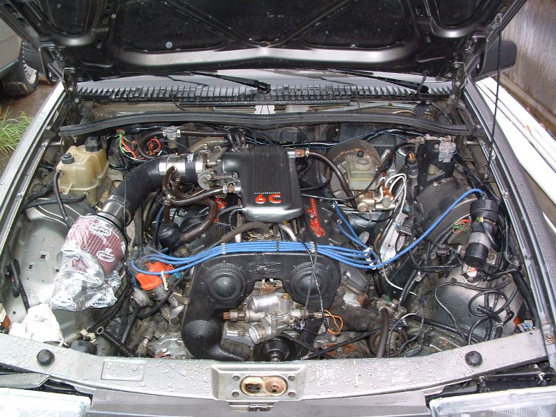

Well, I got the GoTech plugged in this weekend, but that is as far as I got, I need to do some detailing under the hood, and I did reroute the temp sender wires through the right location, after DonG pointed that out to me. I had to put in the new fan and radiator, but the tee in the cooling system was a little rusty, so I am going to take care of that this week, and hopefully get the car running this weekend since it will be a long weekend.
