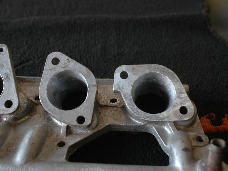

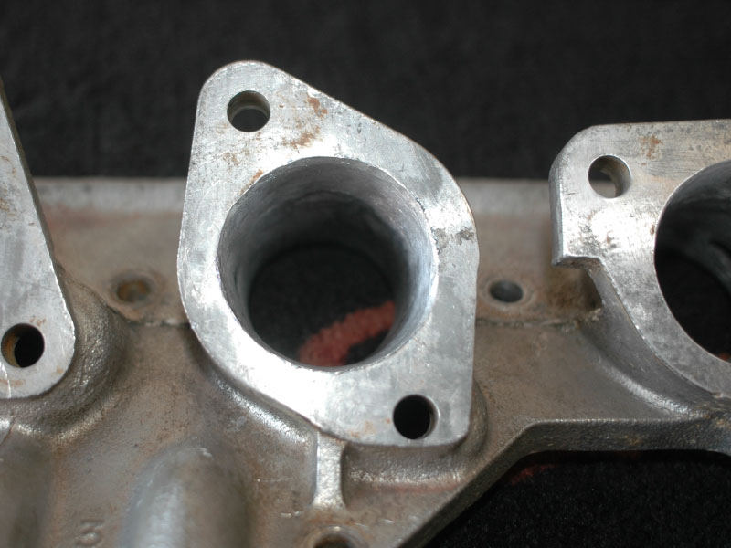

I've spent most of the day porting and polishing a 40mm, 1600 Weber manifold to fit my rather obscene 45mm throttle-bodies... The original 38mm spica manifolds are a bit small in comparison... The only odd thing is the odd off-center match of the 45mm rubber spacers (that I'm way lucky to have found), 1mm on top and 4mm or so at the bottom... See the pic at the bottom.
Tomorrow I'm planning to match the manifold to the head and do some light polishing. I'm not going too crazy on the head as US pump gas is not too exciting and I'm planning to run old school 1600 GTA cams with OK lift and SILLY long duration... I want to have some low-end torque left... The funny thing witth the 1600 manifold is that he bottom heavy offset carries on to the head... TPS and MAP mix will be interesting with that long overlap.
I'm also using 10:5:1 J&E pistons, over-sized liners and a polished/knifed crank...
This engine should be interesting to map, and it'll be my first one... hence Project Gunnieapig...
