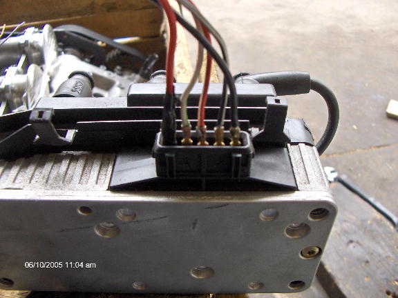

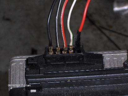

Hey Federico, YES!
Aside from making sure that your connections are correct, the main thing to remember with VW VR6 coil-packs is never to unplug the plug-wires at the coil-pack while the car is running (like maybe trying to diagnose a dead plug/plug-wire/coil-pack...)
Also, never unplug the GoTech while the ignition key is on.
Then, whenever unplugging Gotech or plugging it back in, first disconnect power to the coil-packs!
Here is a picture for the correct hook-up...
