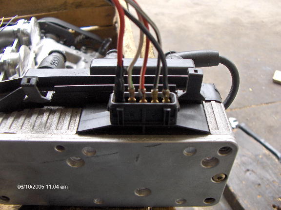

junglejustice
Posts: 624
Location: Granolaville, WA
Post by junglejustice »
VR6 coil-pack hook-up...
4agedub
Posts: 35
Joined: Thu Jul 21, 2005 7:02 am
Location: Johannesburg RSA
Post by 4agedub »
The Golf VR6 coil pack can be used in one of two ways...
1. It has got a built in ignition module as in the picture. Then you use 12v+ ; Signal 1; Signal 2; Signal 3 ; Earth. Gotech must be switched to external fire for this option.
2. You can remove the ignition module, switch the Gotech ecu to internal fire 12v+ ; Signal 1; Signal 2; Signal 3.
