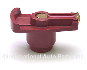

Went down to the local Repco store {like small town parts mart} today and checked to see if they had a distributer cap or rotor in stock. UMMMM no sir sorry but we can get you a distributer cap in a week or so.... $65.00. The rotor would be $95.00 if they could get one. WHAT??? So home I go crank up the computer and find IAP has both bits in stock for $19.65... :shock: But the picture they show is nowhere near the same item I pulled from my distributer. Check this.
Resize of Resize of gtv6 Rotor.jpg (14.21 KiB) Viewed 6978 times

This is the one that IAP has on thier site. Whats the go?
IAPs rotor
IAPs rotor

the first rotor arm is one with a centrifugal rev limiter, when the engine gets to around 6300rpm (it should say on the side) the centripital force of a little sliding contact will over come the force of the spring holding it in and then short out the spark.
the second doesnt have one
simon

Ahh all is revealed.Thanks for that Simon. I shall place my order now. Tim.
