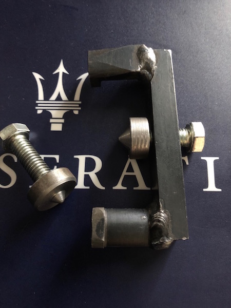

Hey Guys ,
My other toy is a 916 Phase 3 3.2 Spider, due to not much room I made a special slim puller , I have now changed the timing belt 3 times with removing the timing gears with no issue . Carefully put the puller on the gear with a rag under it,once you have tension on the pulley tap the centre puller bolt and the pulley will come off without any damage.

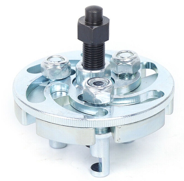

Mate do you have a photo of the puller?
The pulley you have is different from the 164 24V pulley but in principle it should work the same. I'm looking to buy a 3-jaw puller

Please view the photos , the longer bolt is for the step in gear centres.
From the end of the bolt head screwed out to the end of the leg is 52 mm.
