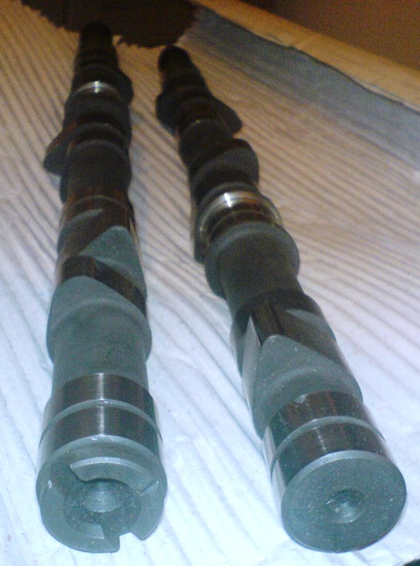

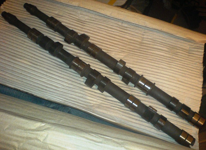

i have a pair of cams, no idea where they are from, they don't have any number on it, just timing marks...has someone an idea?
measured the intake 9.8 mm exhaust is 6mm
will they fit the 2.5 GTV6 engine?
here are 2 pics
Looks like it, but not standard stuff, too nice finish...
Std Alfa cams are roughin the surface and have a visible splitline from the tools.
Is that for a GTV or 164? One cam looks like it has slots for dissy rotor, like on the 164. Either case they will fit unless it's for a 155 V6, which is about 2mm shorter than all other V6s.

shit...i belive they are from a 155.... :evil:
