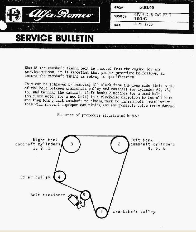

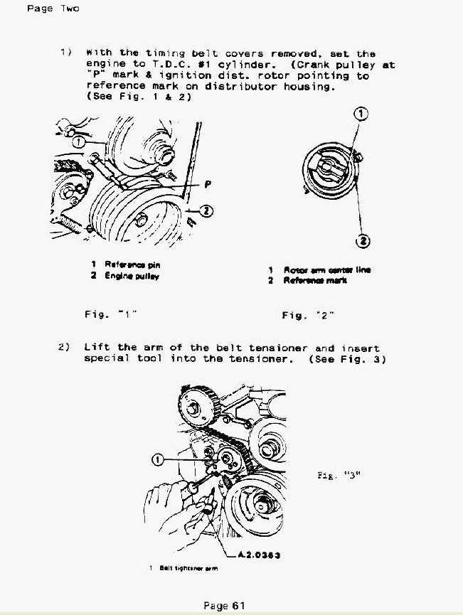

Julio here are the instructions from the AR technical bulletins.
