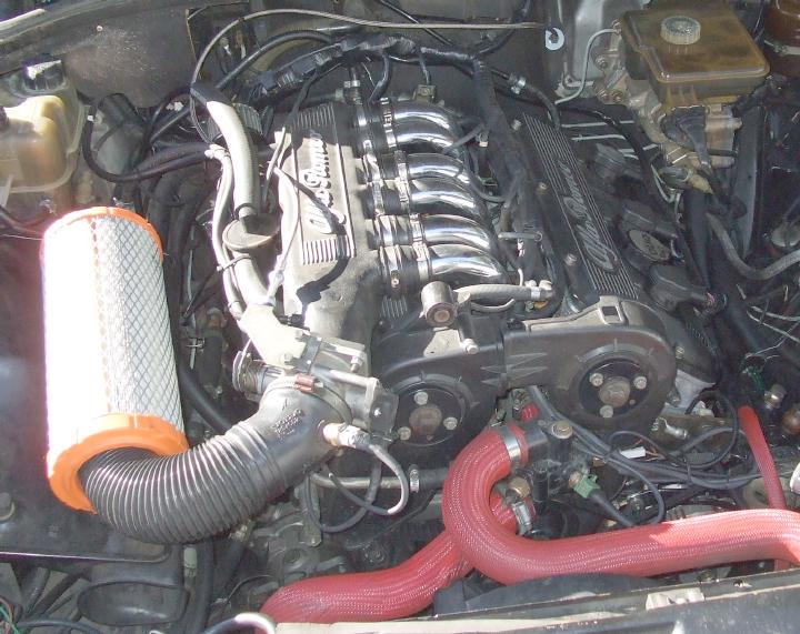

I got a 164S motor very trashed inside
I used the S pistons (should have used new)
new rings
S intake cut and reweled
my old crank and pullys and flywheel (to keep the balence)
I moved the trigger wheel off the 164 pully. (I would not do this again I would change to ribbed belts if I did it again)
I did not order new pistons at the time as my old motor at 230,000 miles the pistons and liners looked like new. but the 164 was very trashed like sand was in the oil. but I had to get the car to together as I need a car to get to work. and I had the spider apart
I still need to modify the org filter cover. so it will look more OEM. I have the round filters there untill I finish the air box
http://www.alfabb.com/bb/forums/showthread.php?t=26315
new rings
- as it is now.
- motor.jpg (80.06 KiB) Viewed 6902 times

"hose covers?"
The red? yea I put that on any burstable hose now.
I had the bottom big host burst once a long time ago on a new motor while driving in the rain. the temp shot up in a instant and I turnd off the key and costed to a stop. but the head was badly warped. With the mesh covers the hose can not burst. it might start to leak but that will give me some time to save the motor.
I used to use the clear but it gets very ugly. The red and black seem to keep the looks.
some times I use the stainless steel but it is a pain to work with and I seem to poke my finger with the sharp wires in the stainless.
