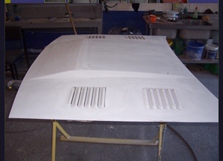

Also depends on type of filters you are going to use . I can give you full sketch of bonnet or you can order one from a chap in UK who has good moulds for the bonnet and larger spoiler . If you do i know another chap in Oz who was going to order one so maybe you combine order .. or just simply modify your bonnet like the green 24v Gtv of Ale drig who is on forum .. probably easier and also good looking as you can do away with the plastic piece

I am going to fit filter socks over the throttle rams.
I don't know what I will do yet with the bonnet.
I will work it out once I try fitting it.

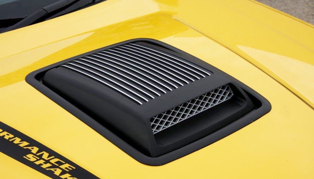

Mite do something different, refer picture. :D

Love the hood scoop, should go well with stickers like "Git 'er done!" or "BIG BLOCK" :mrgreen:
