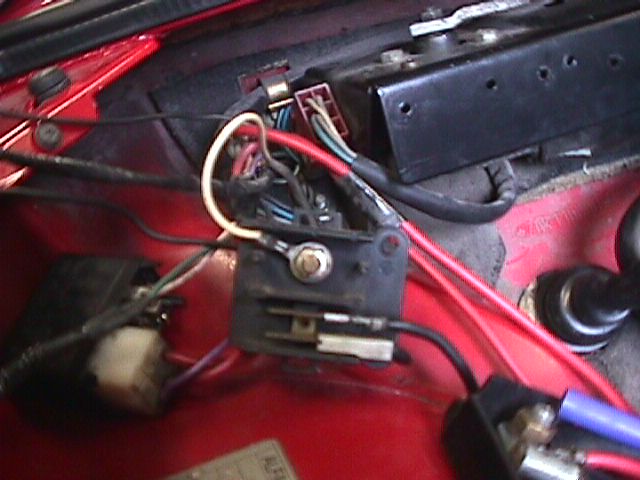

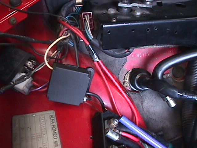

Hi guys!
Here are two pictures of the black junction I´m wondering about. My suspition is that it has had something to do with the old L-jet stem. It has a few wires missing and doesn´t seem to be "in play".
If someone could verify it I´d be greatful.
Here´s a pic with it closed and one with fromt off.
Seb

On my 75t it is the wiring for the alternator, one side is B+ and the other is alternator+ (i.e. when the engine/alternator is running is is 12v positive).

Ok, Mats.
So the question then, is:
Is the Motronic handeling it now then? Since there are a few wires missing in it, I suspect they came from the old L-jet loom, but this I don´t remember.

This is not even in the engine loom, maybe there is a connection on one of the terminals but the box is essentially in the base power distribution system Battery/Alternator/(Starter motor?).
I'll try to remember to look under the hood of a (somewhat standard) GTV6 in the garage tonight. But my memory is crappy so don't hold your breath. ;)

Seb,the thick black wires are for the starter solenoid ,the thin wire was the old ljet`s no.1 cyl firing reference from coil neg.

Ok, thanks Barry!
So the thin(white) wire was for the L-jet and I don´t need it now? And the black wires needs to be connected for the starter to fire up then?

i am going back to the original l-jet and that white wire is disconected on my car . so then were is that white wire go?

I wonder the same thing. Anyone?
I take it Barry was talking about the thin BLACK wire. Barry, can You help us out here?

Seb,
The thick black wires that connect to the male spade connector are the ign. power from ign. switch to the solenoid.Turn key,solenoid pulls in-disconnect at this junction,solenoid dont work.
The thin white wire comes from neg. coil.Test this for continuity with a dmm .It lets the l-jet know when to fire the injectors.The l-jet loom has a wire with an eyelett that attaches to this junction.It goes to pin 1 on the ecu plug.Can also be checked with a dmm.(Digital multimeter.............)

OK, thanks Barry, You´re a rock!
Since I´m using Motronic from 164QV now, I could disregard the white one then? The Motronic ECU should handle it right?
The black ones, I could just connect with eachother then, to get rid of the black connector?
