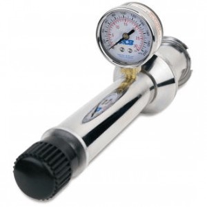

Just to clarify. A radiator leak down test (as opposed to a cylinder leak down) is where you place a pressure gauge on the radiator. It is fitted onto it in place of the cap. It is a composite device that incorporates an air pump and gauge. Normal operating pressure is applied to the system and allowed to rest without the motor running. If the system maintains pressure, it is sound. If the pressure falls in a relatively short time, there is an internal system leak.
I have never used the product that you refer to. Cannot comment but the process seems sound if it works. I do wonder if there are any potential risks to small galleries in terms of reduced or blocked flows.

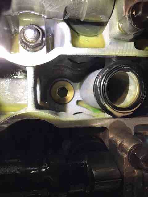

To update everyone, there was still some minor seepage after putting in the k-seal. But nothing as bad as it was originally. I think the brass plugs in the cylinder heads were the cause. There were no copper crush washers and I found coolant in that area.
Putting in some high temp thread sealant and copper crush washers.
