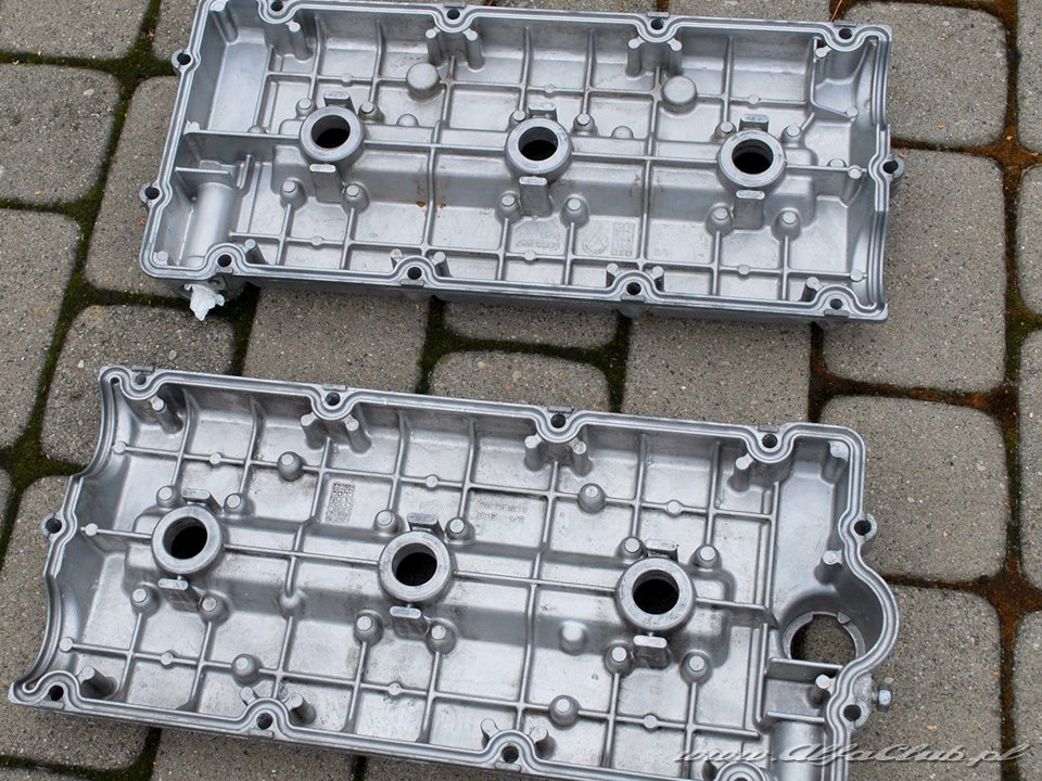

164 24V cam cover gasket interchangeable with 156/GTV ones?
They look similar, but I'm not 100% certain. Serf Efricans should be a pro at this. 164 ones are tough to find. Very easy to find 156 cam cover gaskets.

No don't fit . The gasket design on the newer 24v motors on 156/166 is far superior and never leak as they fit in a recess in the cam cover . Another benefit of using the chain driven 24v motor in 116 conversion along with the better cam tensioner .

So the 156 cam covers have a groove in the middle to fit the bulge of the rubber gasket?
Re: 164 24V cam cover gasket interchangeable with 156/GTV on
Yep . This works really well on front of cover over the cams while on 164 those rubber pieces which come with gasket set are a pain . I always put an extremely thin wipe of silicone on edge of gasket on the 164 to make sure no leaks .
You're right Kev, found this photo:
- gta_cam_cover_underside.jpg (203.36 KiB) Viewed 10496 times
AKA PIP-gasket, push in place.
