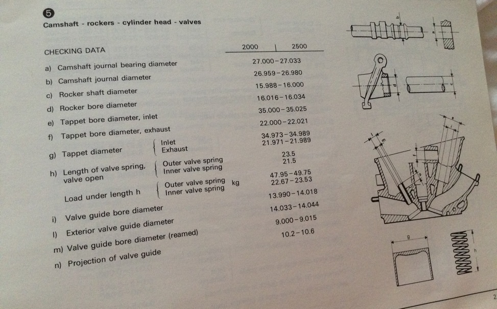

Because I don't have access to a V6 manual, can anyone tell me the heights from the spring pocket, for the valve guides of the 12 valve engines?
Re: Installed Valve Guide Heights?
Hi
From my manual on the 119 V6 .
I will try resize pic . But this is the v6 2.0 2.5 and 3.0 in SA
Duk

Thanks Kevin, that helps out a lot! :D :D :D
I take it it's the same for the inlet guide?
