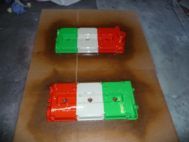

Hello Jim !
How are you, ... I hope you can remember me I´m the Austrian guy who is racing with an Alfa 75 3,0 V6 12V.
Right now I´m building up a new 24 V Race Engine for that car.
I just wanted to ask you if you still sell the 24 V ITB´s and what is the price please ?
See some pics of building up.
Many greetings from Austria
Wolfgang

Re: 12v ITB's
Hi Wolfgang, nice work there! How did you get the block so clean
? Or is it new? I like the 75 Motronic pulley, I prefer it over the newer fwd parts and flat belt. I assume you are going to properly balance the rotating assembly, right?
I will also start on the 3.2 engine ...soon
...Definitely before summer!
