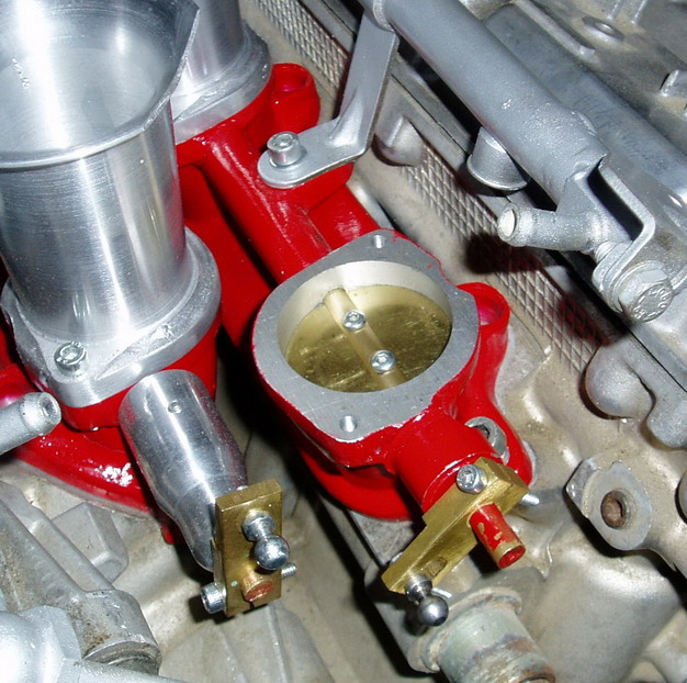

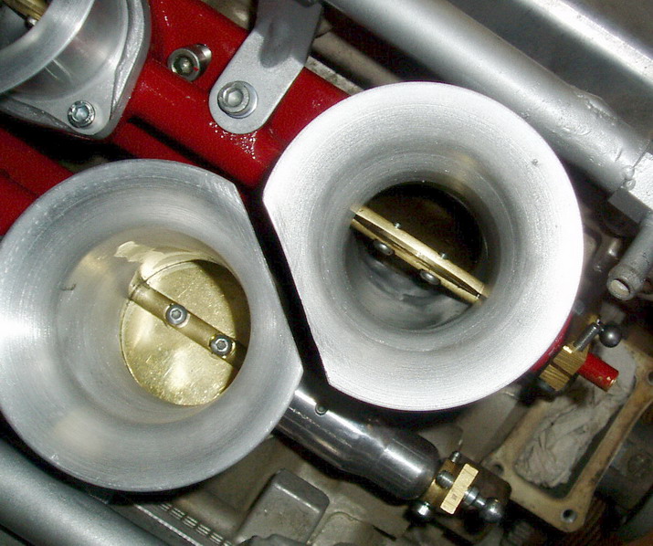

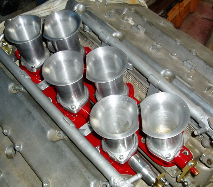

I got the ITB set yesterday and bolted it right away on the spare 24v. All looks good, no mismatch steps inside the bores. You can see the horns are ~5mm apart: my original intention was to use phenolic spacers (same material as under the 12v runners) for some heat isolation. With those in place, the horns will be very close to each other. Still, their distance is influenced by head milling and the fact there are no head gaskets on this engine. Throttle shaft diameter is 8mm and distance from horn mouth to valve is 235mm, about 45-50mm shorter than the std chrome curvy pipes.
Price haggling is ...mandatory in some countries and I finally paid 900€ for this first set, since I helped with the jigs. They've already listed the set in some site for 1300€ (see http://mfsolution.car.gr/parts/?ca=112).

One thing I noticed is that all 3 seem to be on one single shaft.
I think they might bind under temp as the thing expand.
I would think it would need one or two of couplers that let the shafts expand a tad per bank.
unless there is something hidden I can't see.
I thought 2 close together like in a carb or a SPICA was the limit for a single shaft with out experiencing binding with thermal expansion
