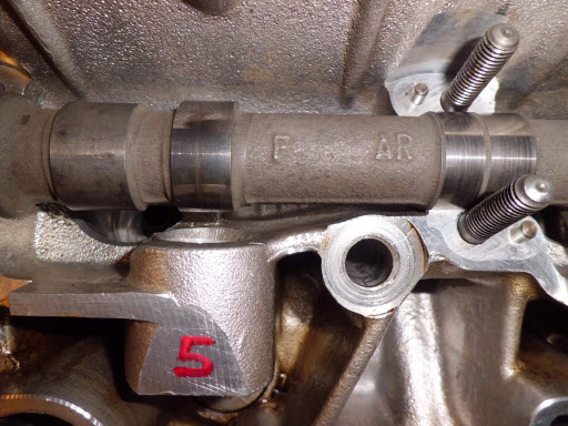

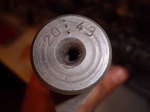

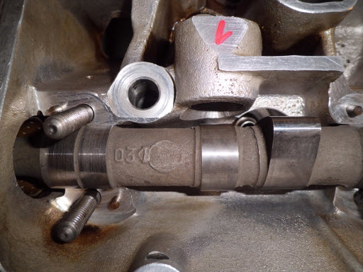

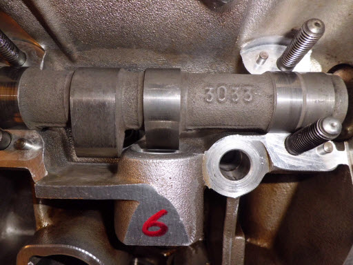

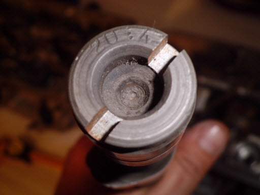

“S” or non ”S” camshaft type, I don’t know the exact type of camshaft I have
but to make things clearer, please take a look at the attached pics here below:
First, is it somehow possible to confirm the exact type of camshaft it is by looking at these pics ?
Does someone in this forum have some dimensions or information that would be easy to use or measure in order to confirm the type of camshaft I have in my hands ?
As you can see, there are some interferences between cam lobes and the heads which are parcularly visible on picture #1 and can be describe as follow :
- Admission lobes hit the head on their side (against the wall where the exhaust tappet is located)
- Exhaust lobes bottom out against the exhaust tappet hole chanfer.
Now, you have to know that the V6 engine I’m currently working on was originally installed in an Alfa 90 2.5. Is there any possibility that the heads of this engine were slightly different than GTV6 heads ? If yes, this would explain these interferences, what do you think about it ?
Looking forward reading you comment and thanks a lot to all of you for your help.

Based on your answer, I’m suddenly a bit more optimistic regarding this swap.
Kind Alfisti Regards.

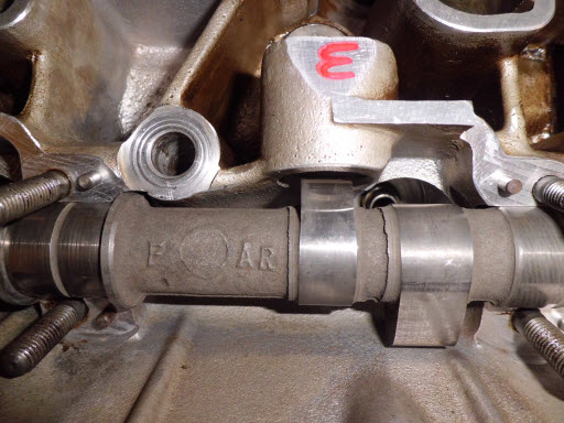

Oups, I forgot one last picture that could help :
- Camshaft #6.jpg (26.98 KiB) Viewed 12919 times

What kind of answer are you looking for? The cam lacks clearance to the casting, it dosen't fit. The only way it would fit is if you grind away some material.
If you are comfortabel doing that and is willing to take the risk of a failure, do it. If not, don't.
Simple.
Simple.
