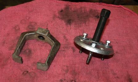

Thought I'd add this bit of info.
Using some advice from Alfisto Steve on the AlfaBB, I made a camshaft pulley removal tool from a plumbing pipe flange. I used a flange for 1/2" pipe. By happenstance the center bolt from my pittman arm remover fit the threads in the pipe flange. I drilled two new holes and enlarged an existing hole in the pipe flange so it'd fit the camshaft pulley.
I attached the pipe flange/pulley remover tool using three 7mm X 45mm bolts with large washers. Then I tightend the center bolt until the pulley came off with a satisfying 'pop'.

Re: worn cam, clatter
yeah..the usually shin banging 'POP' as the pulley flys off and hits you..
sometimes I think these are torqued on to 200ftlbs
The reason it sticks so well is that its on a tapered seat....both the cam nose and wheel have tapered surfaces where they meet. As a result they lock up VERY well without a whole bunch of torque on that nut.
