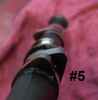

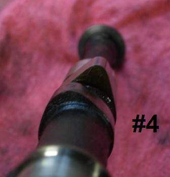

So, I took another, closer look at the left side camshaft. I guess I didn't want to see it before but the evidence is clear to me now. The #6 cam lobes are worn. There isn't enough room to measure base circle & lobe height in situ but looking closely I can see that both the intake & exhaust lobes for #6 are not as 'pointy' as the other cylinder's. The photo makes the intake lobe appear pitted. It may be but I did not see or feel that until I downloaded the photos.
Any ideas as to why this happened? (I do not know what type of oil was used prior to my purchase.) One other thing I noticed is that the exhaust tappet has a series of shiney marks running parallel to the length of the tappet. Is the bore grooved? I suspect this indicates the tappet is not rotating...

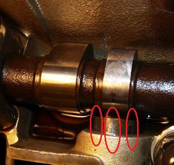

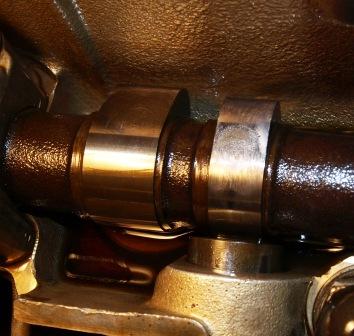

Do you mean the shiney areas visible running parellel to the lifter's travel? (see photo below) I wondered if the lifter wasn't rotating and the marks are due to gooves in the lifter bore?xrad wrote:exhaust lifter has a wear mark on the side.....maybe loose in the lifter bore?

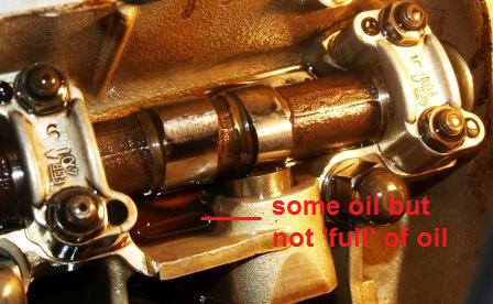

Also, I noticed that there was some oil in the areas around the camshaft but it wasn't 'full' like the right side head. Does that say anything?

Yep, those marks...see what the cam shaft and bearing caps look like when you pull the cam....Clogged oil port?

How would I check for adequate oil supply to the cam? I assume it comes up via the oil passages that have the O-ring & roll pin between the block & head.

I would think that you have to pull the head and really clean everything out to be sure.

You know what I see on the sides of that lifter? Corrosion pitting. If that has happened, I be that lifter has stuck at some stage, that'll wipe out a cam lobe.

I removed the left side camshaft for a closer look. It is obvious more lobes are worn (perhaps all of them?). The bearings look good. I am still concerned about whether the cam is getting an adequate oil supply. If I can attribute this to the PO using the 'wrong' type of oil (inadequate zinc) then I'll feel better about replacing the cams/lifters and driving it.
