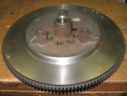

My machinist first determined the imbalance on his dynamic balancing machine. Then the flywheel was lightened. He then put it back on the dynamic balancing machine and drilled holes to match the imbalance before removing material (you can kind of see them in the pic).
In order to get the machinist to do this I had to provide a crank or pay him to build a mandrel. I chose to let him borrow the crank out of my 2.5.
According to the machinist this method gets the balancing pretty close but it isn't as good as balancing the entire rotating assembly.
