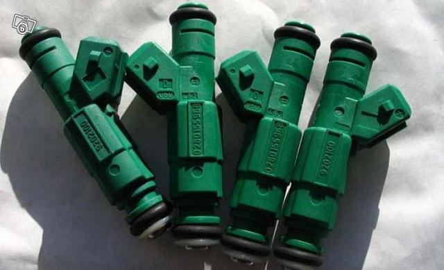

Volvo R injectors (Green), 365cc. Available cheap everywhere. :)

Mats wrote:Volvo R injectors (Green), 365cc. Available cheap everywhere. :)
Do you mean this one:
B 280 431 129
of the same sheet:
http://www.bosch-motorsport.de/pdf/comp ... s/EV_6.pdf
Re: 3.0 V6 12V Twin Turbo
I have no idea, sold the ones I had and replaced them with Siemens 620cc units. 8)
Edit, these are the ones.
Bosch nr: 0280 155 968
420-427cc @3 bar
465cc@3,8 bar
Green Volvo R injectors

http://link.marktplaats.nl/240113564
Just search a bit and find things like these... :wink:

Giuliettaevo2 wrote:http://link.marktplaats.nl/240113564
Are you sure they fitt?
I can make a good deal with the seller.
What the heck, I just bought them. Hopefully one step closer.

there are only 4 of them??
is that right 12 ohm?

rz wrote:there are only 4 of them??
4 is more than enough.
I'll drill extra holes for the other 2 cylinders and use two of the old injectors.
Two of the old injectors should equalize with one of the new injectors for the fuel flow.
Just joking, bought 6 of those red guys.
Thanks Giuliettaevo2 and Mats for the advice!
