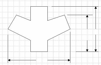

I am working on a kit car and I hope to use the 2.5 liter V6 from a donor car at some point. My problem is I am not sure if it will fit in the car that I am designing. Does anyone here have some basic dimensions of the engine I could use to see if the V6 is a viable option? I have attached a pic of what I am looking for. Let me know and I can also shoot you an email of what I am looking for. I also ask for the length of the engine with and without acessories. All measurements within an inch is fine. Nothing too technical needed at this stage.

I don't see the picture you attached. I am curious about what type of car it's going in. Do you need measurements with or without exhaust manifolds? What about the height? Do you need that with or without the plenum?

Oops! I have added the picture. Without the exhaust manifolds is fine as I am sure I will have to make them. The height should include the plenum please. The plenum is my biggest worry as I fear the engine will be too tall. I am trying to stay away from a hood scoop if possible.

It's about 21 inches side to side. The height from the bottom of the stock oil pan to the top of a GTV6 plenum is about 28 inches. With another plenum and intake runner set up it could be knocked down to 24. If you really need it to be low you can shorten the oil pan. For a picture of this check out the Alfa V6 powered motorcycle on my web site. It's oil pan is so short people think it's a dry sump, but it's not.
