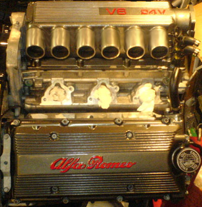

What do you think about giving some extra length to plenum pipes and keeping intake runners stock?
Will this improve some hp/torque rate or not? Idea came since there is a lot of room for moving plenum backwards on rwd car...
brg
brg
- A bit of photoshop tuning, to make things easier.. :)
- Intake 24v.jpg (76.18 KiB) Viewed 9978 times
