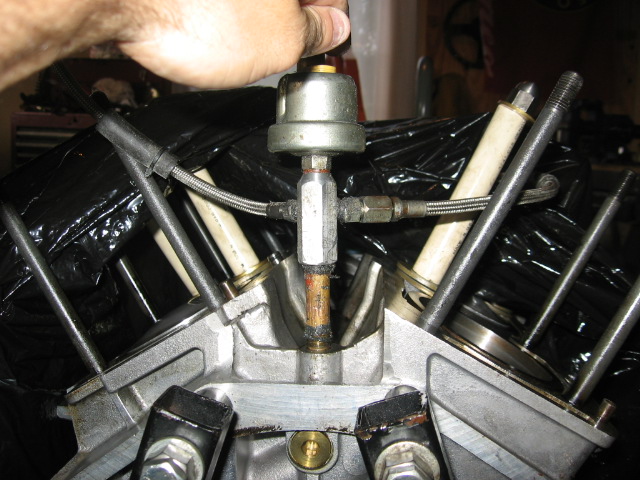

depends how far you want to go, but you could plug that head galley hole and do something like this
tap lines to back of head oil galley

Hey interesting !
Did you experience same trouble ?
Not me, but the guy who rebuilt a racing engine 2.5 did have oil galley leaks and blocked off his head to use this system instead. It just came with all the internal parts I bought from him (he actually converted a 2.5 block to 3.0 liners and 10.5:1 pistons, with 2.5 crank, and 2.5 heads, C+B cams....quite a Frankenstein) I bought the parts after the car was wrecked for Very good price to go into my rebuild.....
